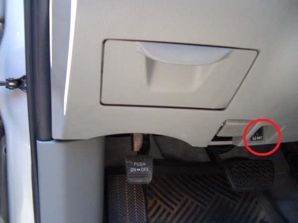

    i was wondering if anyone new how to reset the tire sensor on my taco cuz i tried doing it but it would just flash a couple of times and then stay lit again.... Is it because of my spare that i still have under the truck bed...??? Or will it not reset cuz of the new bigger tires there 285-65-R18 ...???
    Thanks Amir

    It outlines how to reset in the owners manual. Do you still have one?

    There is a reset button under the steering wheel:

    yea ill check it out... My bad that never crossed my mind hahaha.... Thanks for the quick response... and thats y this site is freaking great..... i tried the rest button but it didn't work ill def try it again tho....
