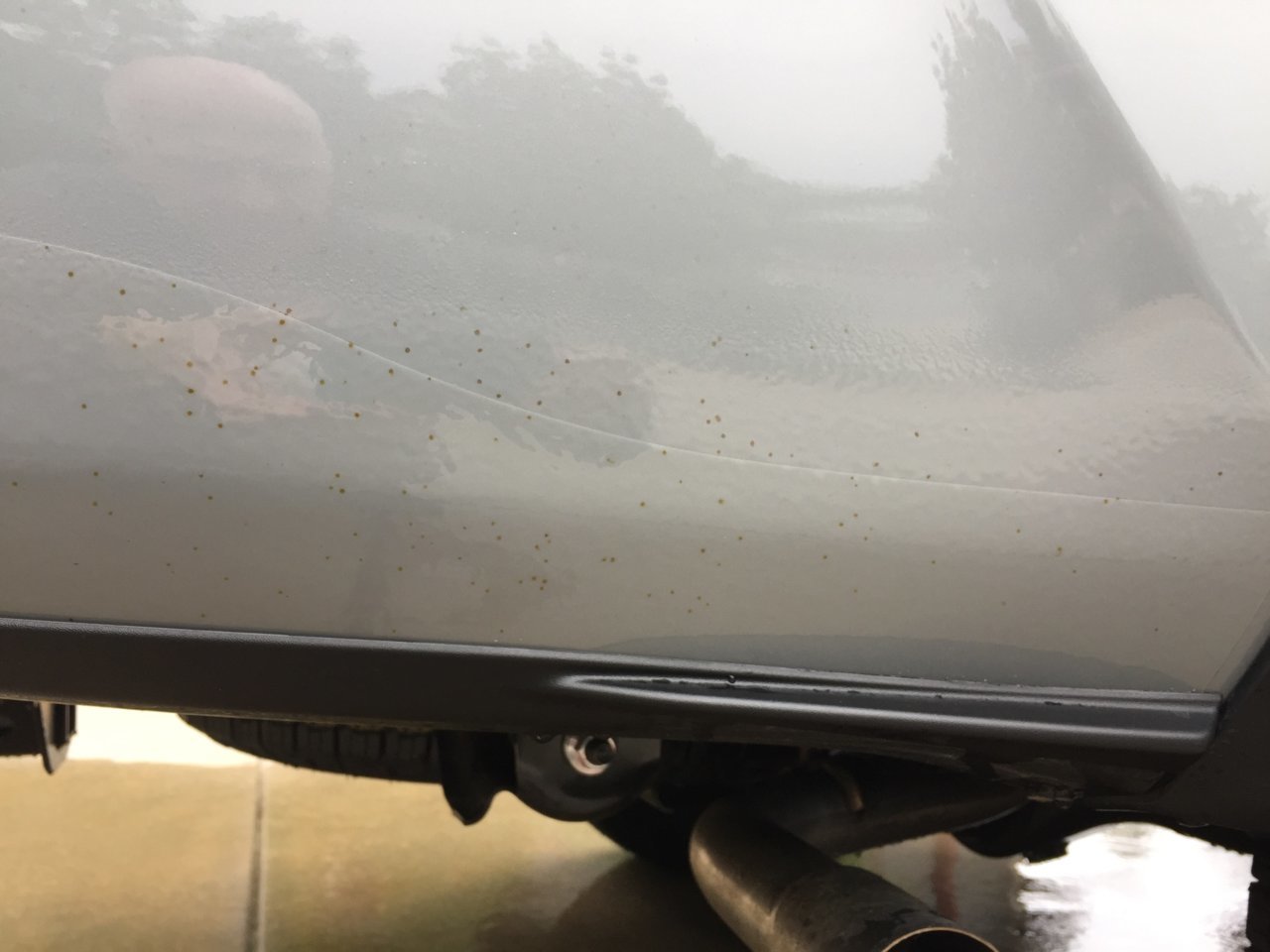

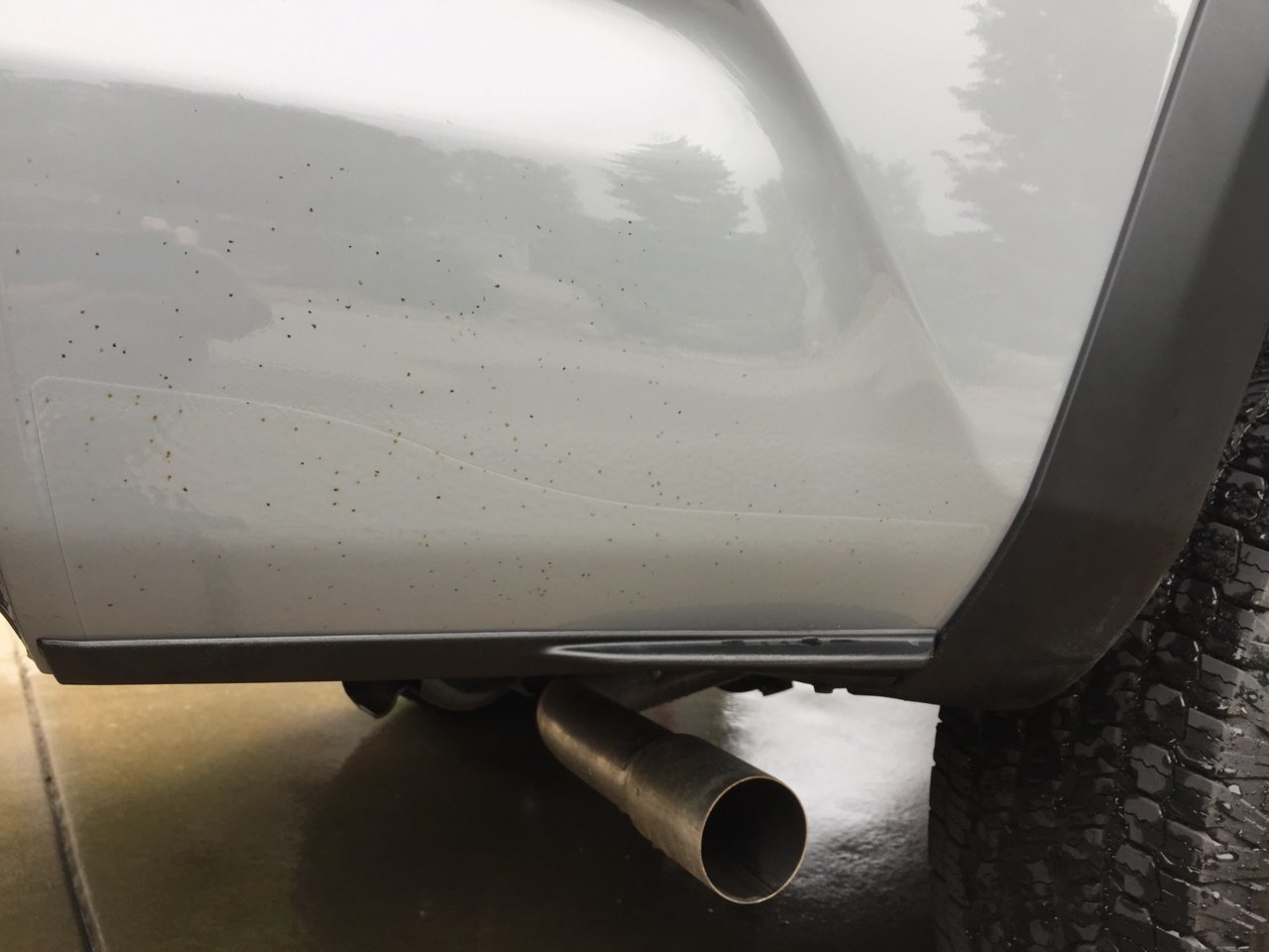

    Add another victim to the list. It was pretty easy to remove from the upper paint surfaces (and 3 pairs of pants, from rubbing up against the rear tires before I figured out what was causing it) with GooGone, but rocker panel surfaces of my brand new Cement Off Road are completely speckled and nothing will remove it...magnification shows that it has nicely penetrated into the finish. Dealer tried to remove without any luck either. But so far they've totally dismissed me, and are not accepting any responsibility...they say it has to be something else I drove through "because we've never seen this before." Classic dealership BS, had hoped for better from Toyota. Sent them all these threads to convince them it's not my imagination, no reply yet. Yeah, it's a truck and I hope it gets properly dinged up soon in the mountains where it belongs, but it's the principle...
    So yeah, if you order new light-colored Off-Road, be SURE to tell them you won't accept delivery if they put this stuff on. Especially if you take delivery when it's hot, because the stuff gets runny and continues to spin off even after a couple of scrubbings. Actually, it might be more satisfying to watch them spend hours trying to scrub it all off the tires before you accept it.

    Just to explain previous photos...first 2 are duplicate, and is before cleaning. Bottom one is after removing from smooth paint above rocker.

    That REALLY sucks! Tire shine is the devil's spawn. You're better off staying away from it completely, especially if you off-road.

    They will compound out if you get a professional detailer to work on it. I speak from experience!

    Clay bar

    Have you tried using a clay bar?

    I had the same issue yea on my cement off road, good wash, proper clay bar application, and then wax will get the job done
