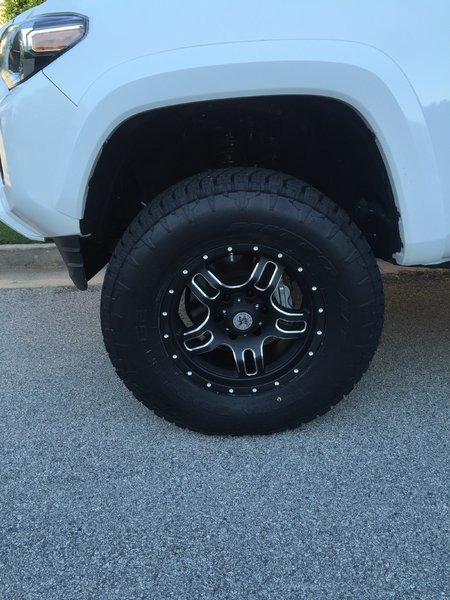

    Okay, this is 3" front and 2" rear lift on 16 TRD Sport RWD. 17x9 with 10mm offset puts the nitto terra grapplers g2 in 285/70-17 perfect with no scrub anywhere. The ride is great. Mileage on screen has gone down by 4% but there's a 7% gain due to diameter so I know it sounds a little hard to believe but mileage is UP by about 3% to around 21.6 around town with. Few interstate miles thrown in. Biggest issue after 3" front lift is the upper control arm rubbing. I mounted a 285/70-17 on the stock alloy and it rubbed hard on control arm and it was far to "tucked"... So as much as I feel like I need to scour the planet for the coolest wheels, discount had these and they're spot on and were $125 each. Heck, even gave me $200 for take-offs with almost no miles and in pretty well set. I'll take a few more pics if anyone wants them.
    I'll answer questions and check back for answers.
