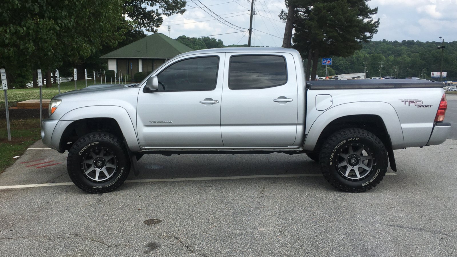

    I’m looking get Cooper AT3 XLTs and would prefer 285/70-17’s for a 2.5” 2nd gen Taco. 80/20 street/ off-road. I have 265/70-17s now with only minor full lock reverse mud flap rub.

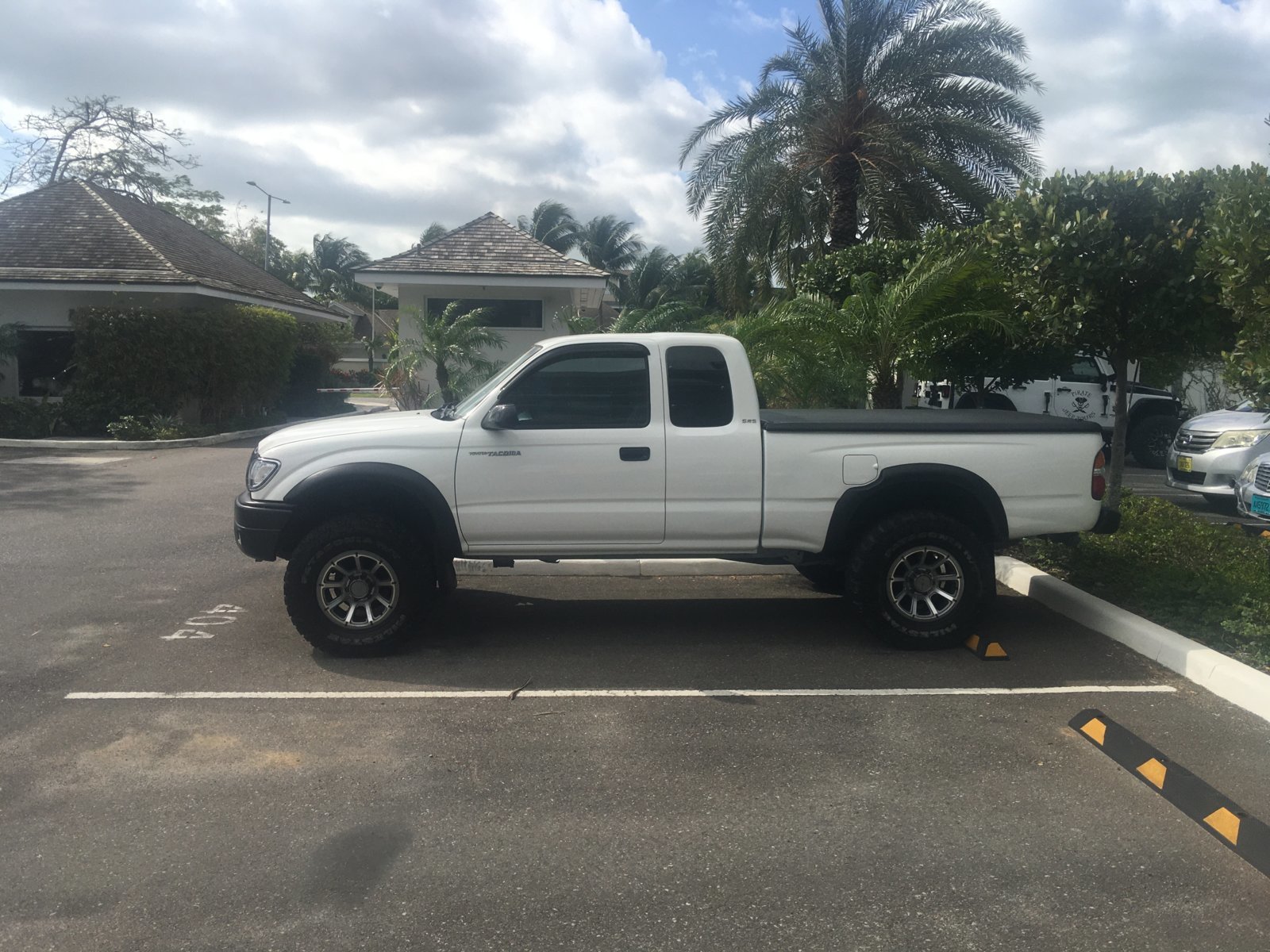

    I omitted to say that there are spacers on there now- 2" I believe. I have a Gen 1 as well and they are slightly different and I have trouble remembering because i only occasionally tinker with them.

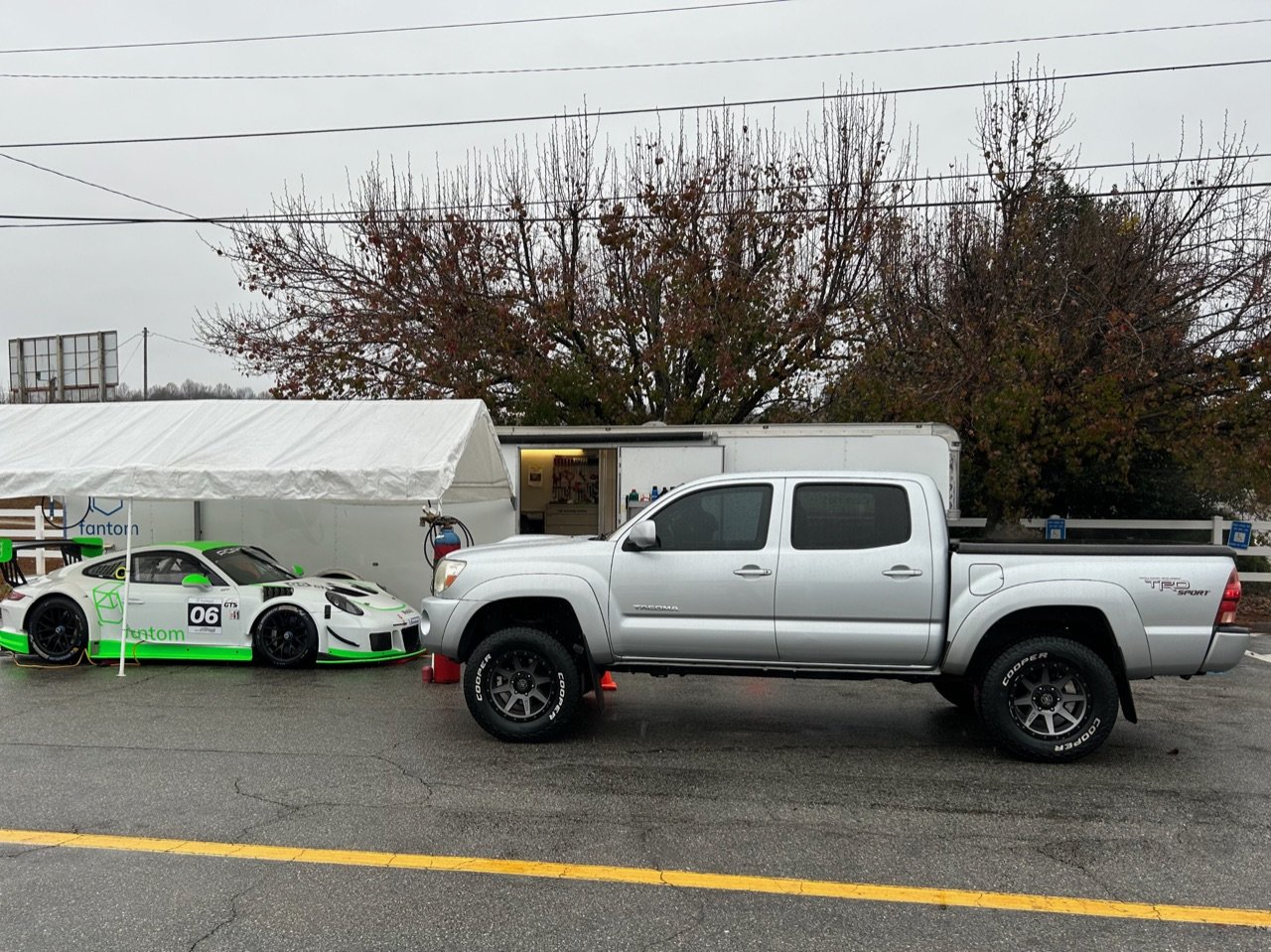

    I ended up ordering
    265/70R-17 COOPER DISCOVERER ROAD+TRAIL AT
    Apparently they replace the AT3 4S which my son has and really likes. Also found an early review that was quite favorable. I'll have them next week and we'll see.
  16. Dec 1, 2023 at 9:34 AM
    #16
    Ritter
    Ritter [OP] Well-Known Member
    Nov 1, 2009
    #25256
    118
    David
    Atlanta/ Nassau
    08 Taco Crew TRD and 03 Xtra 4x4
    New R&T are on and night and day from the Evolutions. Silky smooth and QUIET on the highway. Great in the rain, but not been off-road yet. I think they will be fine for my usage. IMG_7048.jpg
