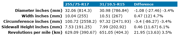

    First gens came with 31 x 10.5 15 in some stock configurations. So you aren't far off from that.
    from the online tire size calculator
    You may have to perform the pinch weld mod and do some minor fender well trimming.

    i didnt know they came with 31's.. hrmmm..
    but yeah im very interested in getting a set (and yes they are for sale in the WTS section, lol)
    i cant see going from a 31, to a 32 a big deal.. just not 100% sure.. since its a Pre-Runner..

    The 98-00 TRD's came with 31 10.5 15's. (Not sure about the previous years but they will fit regardless) They switched to metric sizing after 00 to the previous. 15" wheels will fit on the 01-04's also.
