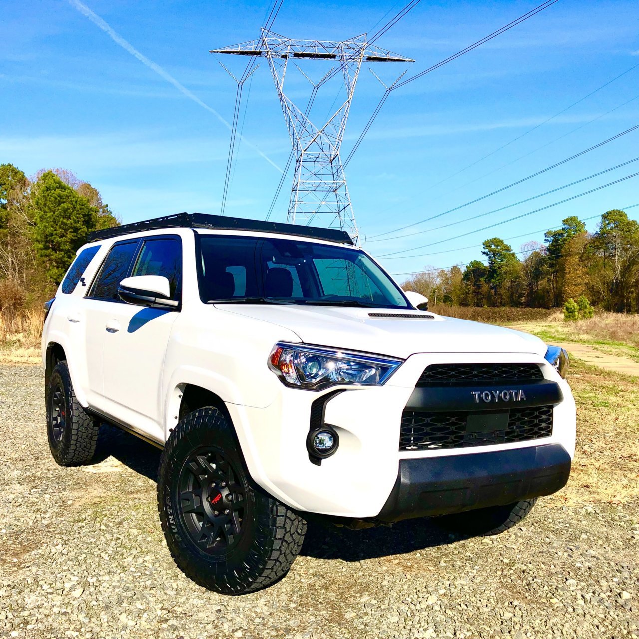

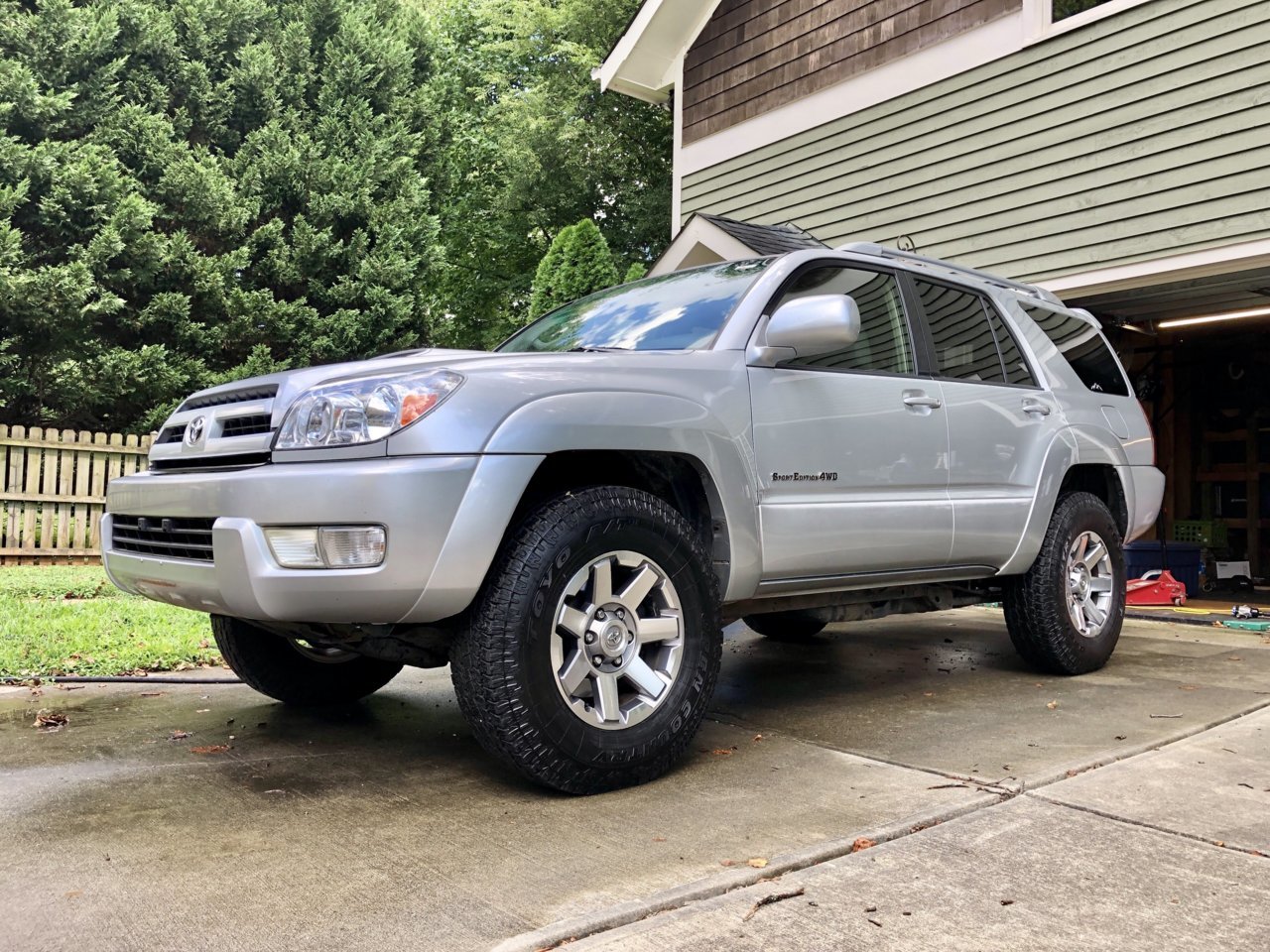

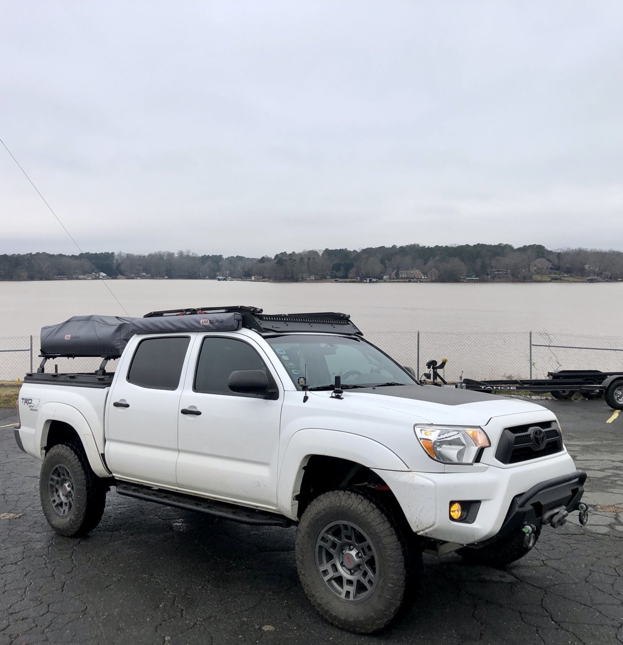

    If your not set on that size but just want a bigger tire you can run 255/80R17s, it's skinnier tires but performs better in most offroad situations and is lighter than the size you mentioned. And it's over 33" tall. I run that size on all three Toyotas I own.
