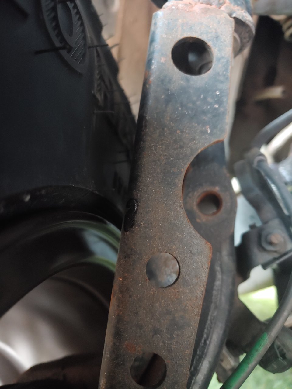

    No idea, didn't know spindle gussets really varied that much. 0716201959b.jpg

    it just has a mild bend that might make the slightest difference since where talking about a .15 in difference with backspacing

    Didn't know that. I am not particularly worried about the wheel, as it is metal it is not going to move. But i am worried about the tires rubbing on the spindle when I air down for general offroading. However I doubt airing down will increase overall track width by 2 inchs, pushing the tire the 1 inch closer to the spindle to rub. I picked up some 1/4 spacers I am going to see if work. I am still working on fitment myself. I got alpine designs front cab mounts, which are well out of the way. My next problem to tackle is rubbing on the fender well behind the wheel. I believe i have to trim back the stock fenders a bit, and cut or bend the pinch weld right there and figure out some sort of new fender liner. Still saying ideal fitment for tacomas is 17x9/17 -10 ish. I grabbed my wheels for 170 bucks a piece so i am not really complaining. Theres some black rhinos in a pretty good fitment that are 180 something a piece on bb wheels right now, I might have gone with in retrospect.
