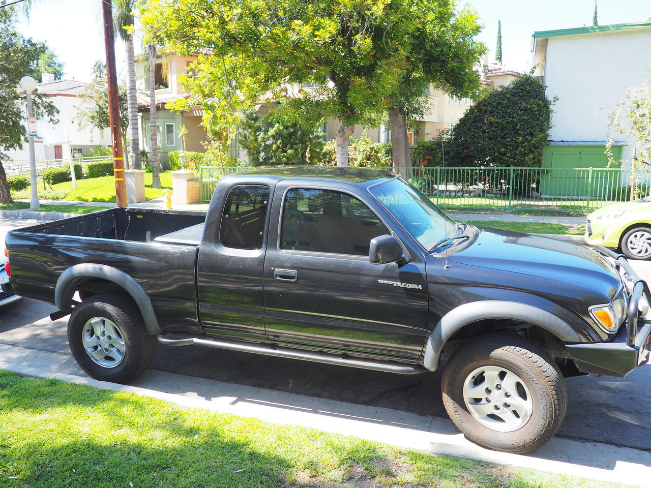

  6. Sep 26, 2017 at 2:53 PM
    toyrunner
    toyrunner Puddle Jumper
    Jun 5, 2016
    #188846
    200
    Danny
    Pasadena, Ca.
    2004 4X4 Tacoma TRD Xtra Cab
    Kings in front, Bilstien Reservoir rears, Custom sway bar disconnects, 265/75 16 BFG AT's, ARB front bumper and FROR rear bumper. Bao-Feng 2 meter radio and Cobra CB
    265/70/ 16 with 2.5" lift. No rubbing so far. I had some BFG All Terrains 265/75 16 and they did rub at full turn and entering my driveway which gave about half stuff. I forgot to write this in here. Sorry for confusion. My 265/70's don't rub! lol

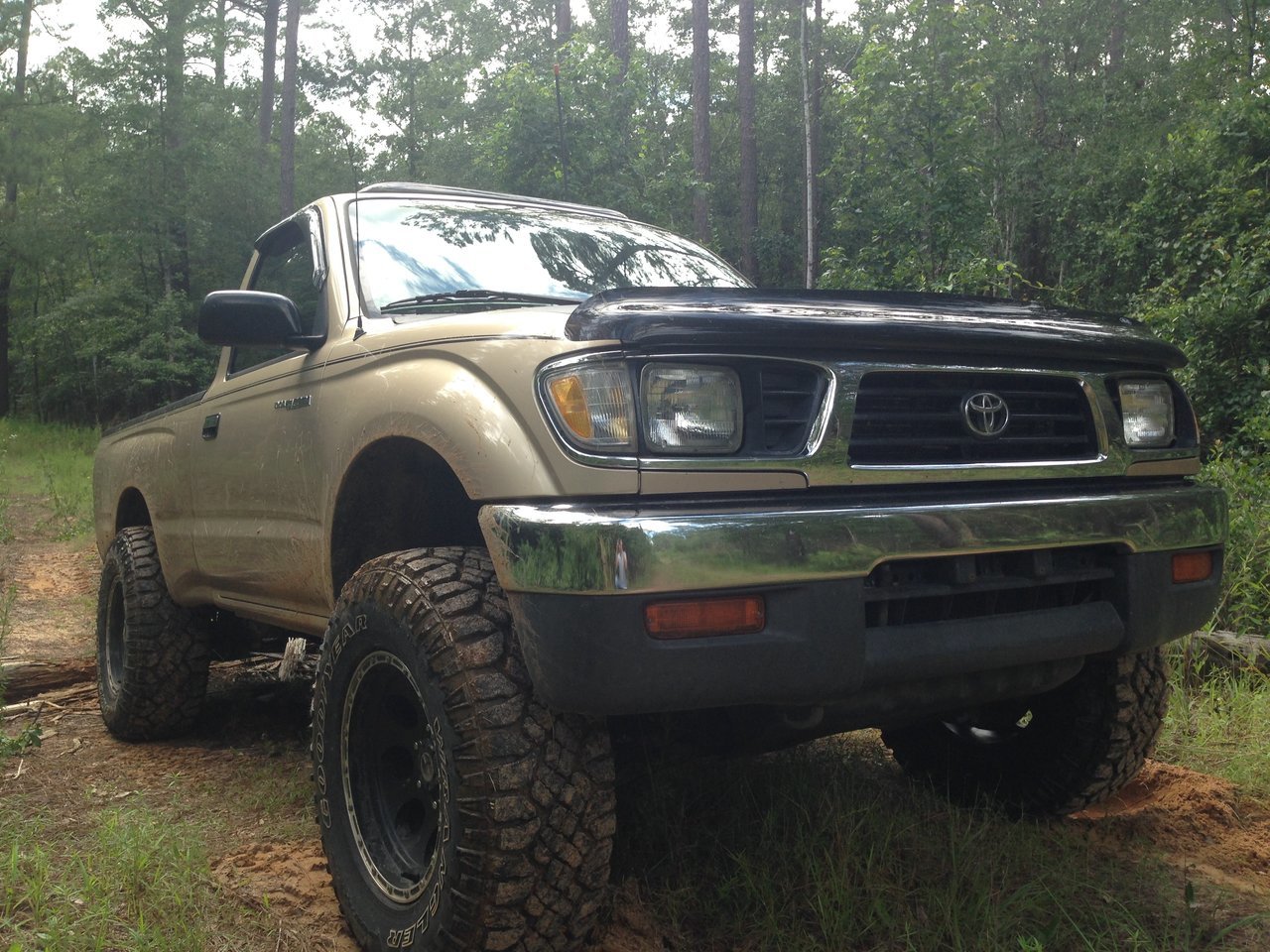

    Thanks man
  12. Sep 26, 2017 at 5:53 PM
    YotaOverAll
    YotaOverAll Backyard Performance
    Jul 9, 2012
    #82254
    14,700
    Jessie
    Panama City, FL
    02 Prerunner SR5
    3" Toytec spacers, Bilstein 5100s in the back with add a leaf and overloads removed.
    I ran 285/75r16s and 33 12.50s on 2.5" in the front

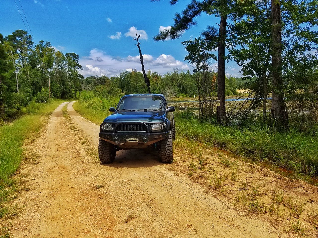

  15. Sep 27, 2017 at 6:27 PM
    shawnster88
    shawnster88 Well-Known Member
    Aug 19, 2012
    #85096
    355
    Shawn
    Defuniak Springs, FL
    96 Tacoma Reg cab 2.7 5 speed
    OME 881 coil springs, OME nitrocharger sport shocks front and rear. Nitro 4:56 gears. ARB rear locker. Shrockworks front bumper with Warn M8000S winch. 17x9 SCS Ray 10 wheels w/ 285/70/17 Toyo Open Country RT Trail tires. Corbeau Trailcat bucket seats. Go Rhino roll bar w/ KC Daymaker lights. GMRS Radio. Ham Radio.
    Can't tell much being it's not on level ground. I got 265/75/16 with about 1-1.5" I believe. Never rubbed.

  17. Oct 24, 2017 at 5:29 AM
    #17
    jacksj1
    jacksj1 [OP] Well-Known Member
    Aug 25, 2017
    #227977
    74
    Jon
    01 Tacoma xtra cab 4x4 5spd
    3 inch lift
    Damn dude, I am digging your ride... but those tires look bigger than 265/75/16 and that lift looks like at least a 3 inch....I could be wrong but regardless it's a tough looking Yota!

  18. Oct 24, 2017 at 6:46 AM
    #18
    toyrunner
    Jun 5, 2016
    #188846
    200
    Danny
    Pasadena, Ca.
    I had some BFG All Terrains 265/75 16 and they did rub at full turn while entering my driveway which gave about half stuff. It would be annoying when wheeling. Maybe I need more lift! :gossip: The Wrangler Dueler 265/75/16's did not rub. It was the lugs on the same size BFG's that did. I have a 2" lift. This is why I went to the smaller tires. YMMV
