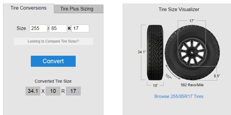

  9. Jun 22, 2022 at 11:12 AM
    #29
    EFG
    EFG Well-Known Member
    Mar 27, 2022
    #393635
    223
    Eddy
    New England
    2022 Tacoma TRD Sport
    factory lift kit, Stinger Off Road Stereo, Customized leather interior, Backflip X4S Tonneau,
    Sports got 17” wheels
    I don’t think a 255/85/17 would fit…if they even make one..
    coma toy[QUOTED] likes this.

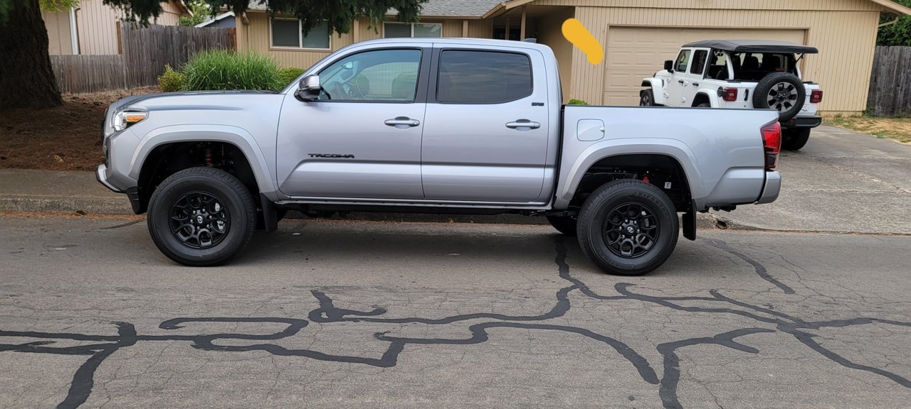

  18. Jul 25, 2022 at 6:59 PM
    #38
    Integerdy
    Integerdy Aspiring "SR5 Pro"
    Jul 31, 2021
    #372781
    867
    Eric
    So-Lame, Oregon
    21 SR5 Silver Sky DCSB
    With stock wheels (+25-30mm offset) you can fit 265/70/17 or 265/75/16
    If you want 275's, you need near 0 or negative offset wheels. I have the TRD Lift kit with TRD Pro 4runner wheels wrapped in 275/70/17s

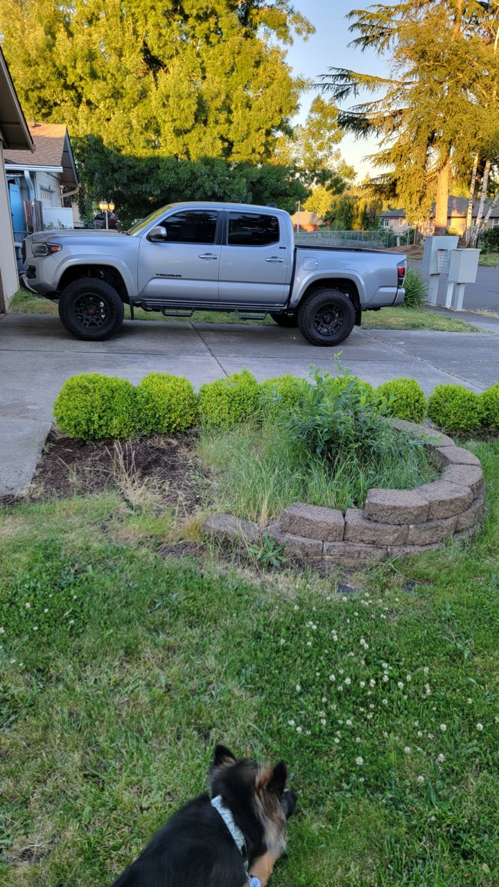

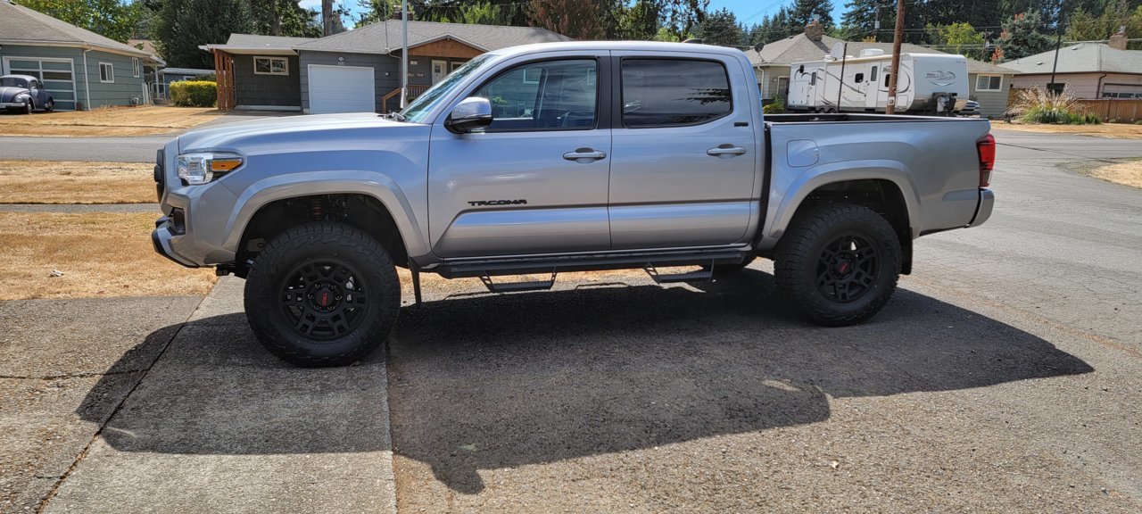

  19. Jul 25, 2022 at 7:04 PM
    #39
    Integerdy
    Jul 31, 2021
    #372781
    867
    Eric
    So-Lame, Oregon
    I have an SR5 and it took me a couple months to save money for new wheels and tires after installing the TRD Lift kit. Drove around looking like a dink for a bit lol
    Here is my SR5 with Lift kit before new wheels and tires, and after with wheels and tires
    TaCosmere likes this.

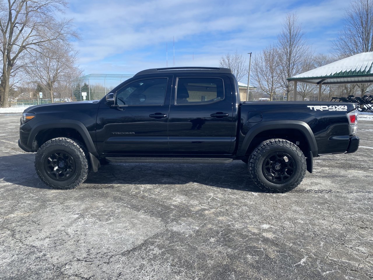

  20. Jul 25, 2022 at 7:41 PM
    #40
    Kalalau
    Kalalau Member
    Jul 6, 2020
    #333567
    19
    Lisle, IL
    2021 Black Tacoma TRD Premium
    Toyota TRD Lift, Bakflip MX4, Black RIno Overland wheels, BF Goodrich KO2 tires, Tinted windows
    275/70/17 on my 2021 trd off-road 7k miles no issues
