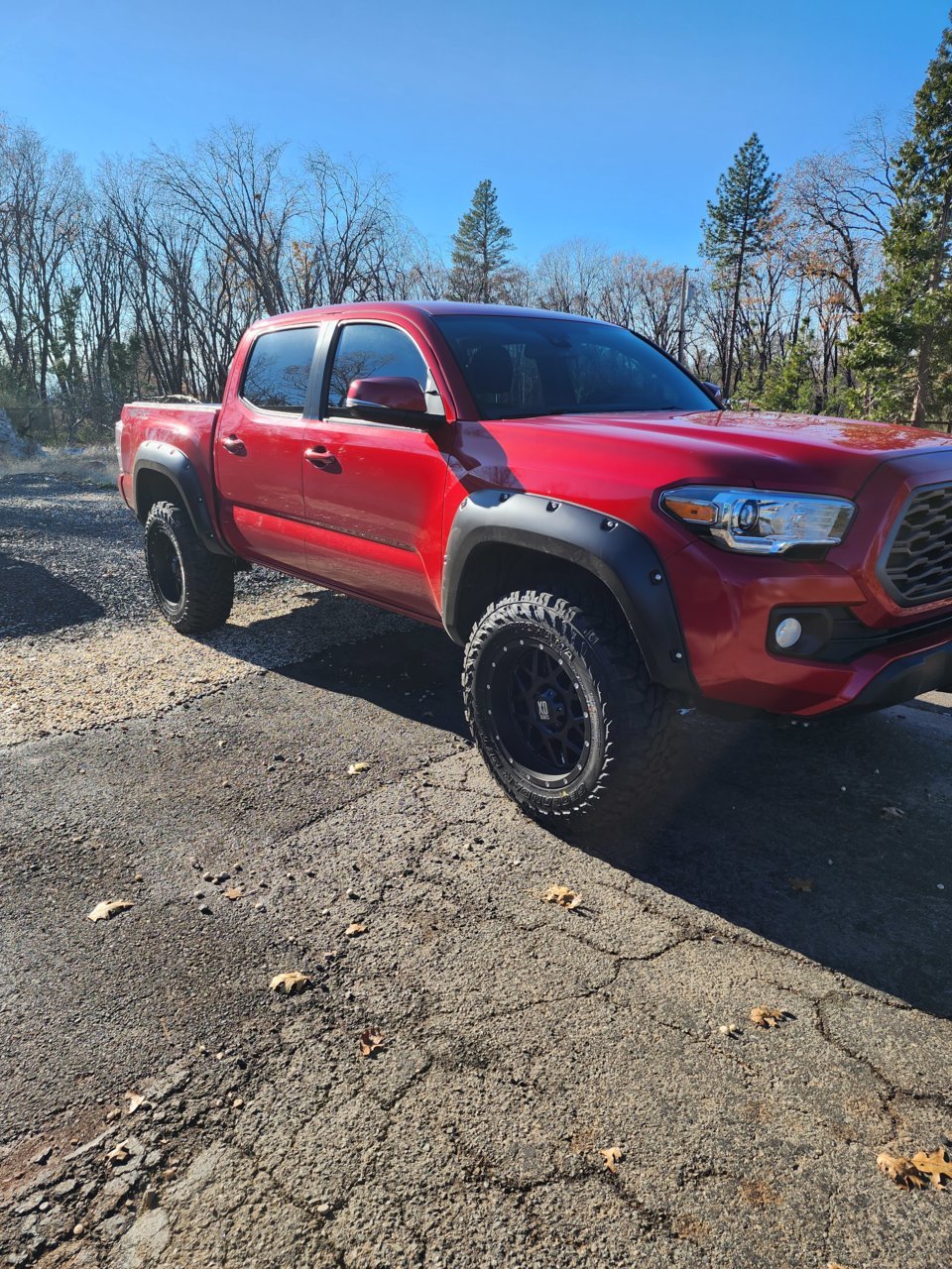

    20221216_133700.jpgmy truck has a 2 inch light front one inch in the back. I'm running 275/65/18....no issues

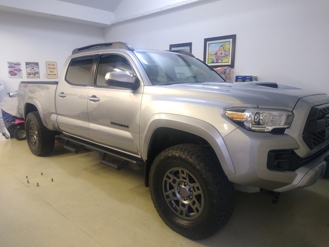

    285s work for me, no rubbing, no cab chop mount, no trimming!
