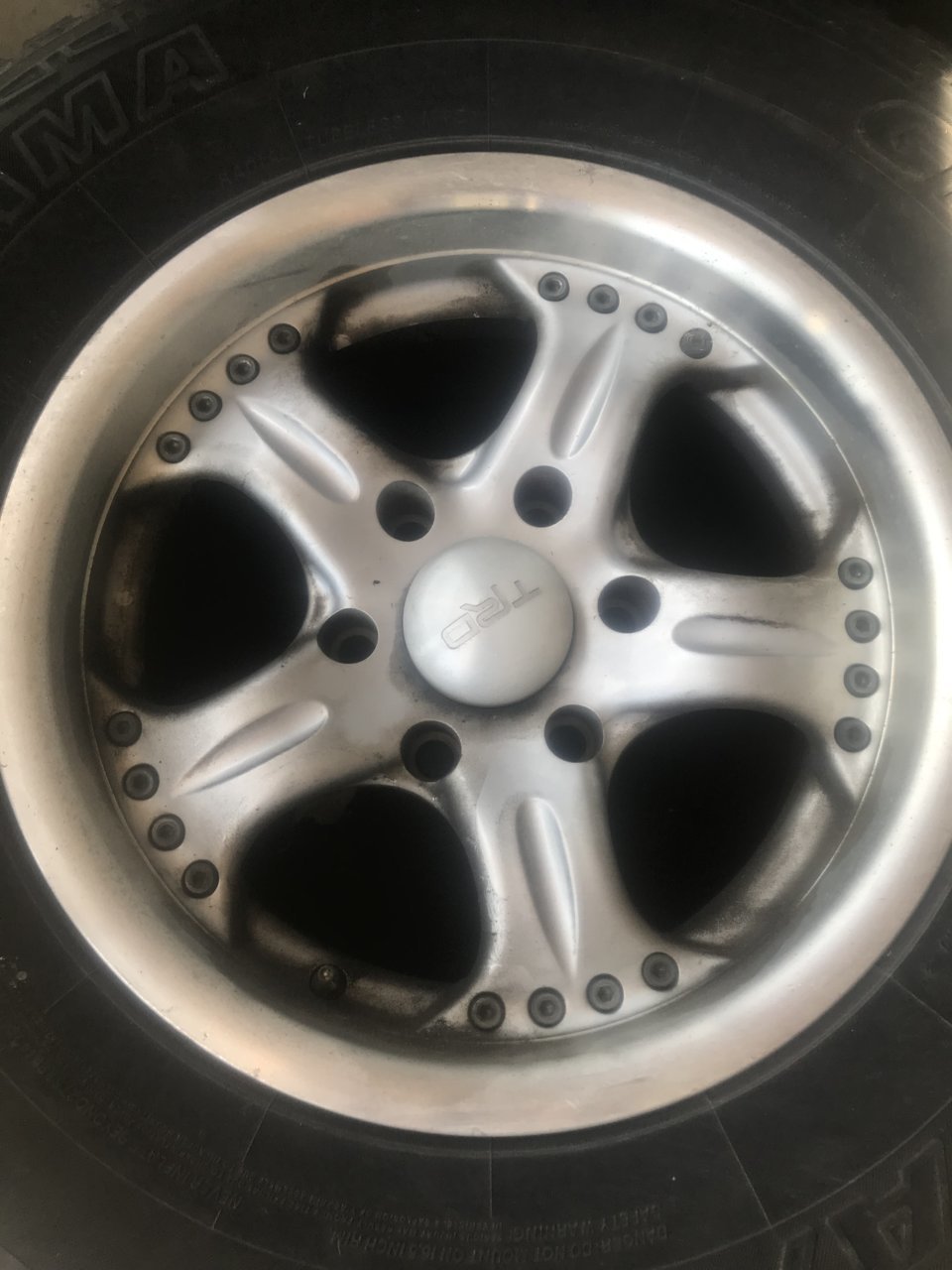

    I currently have the five spoke TRD rims in 16” and looking for size upgrade to match a recently purchase ICON suspension package. ICOn recommends 285’s but they only go to 275 with that rim size. Previously I ran p265/70r16. Any recommendation for a comparable size?

    255-85-16???

    LT285/75R16 not an option?

    Thanks. Looks like those will work.

    Do you want mud terrains? I think most 255/85 R16 are MT. I think there are a few ATs but not many.
