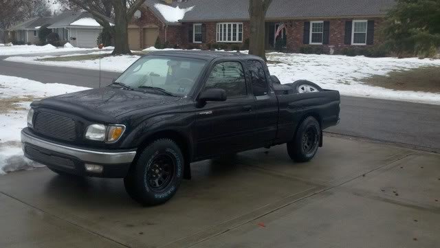

    I have the wrangler radials on mine right now too... I did have some rubbing on the tops of my front wheel wells on big bumps. I noticed it the most when I had 1 or 2 other people in the cab with me, just enough weight to push the front end down slightly. It didn't break anything but it was loud as hell and scared the shit out of anyone else that was in the truck with me.
    Here's mine at stock height with the 235s
