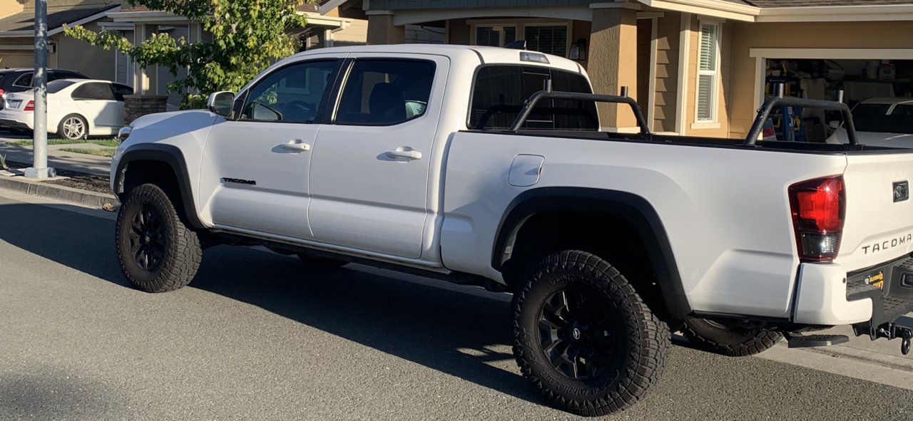

    Need help with tire size needed. I have a 16 offroad that I have put a 2 inch ole man emu lift on thinking a 285 75 16 will work anyone know 100% ?

    On stock wheels you will rub on the UCAs. You will also probably rub on the plastic wheel liner as well. If you go offroad you might rub on your cab mount if you flex your suspension.
    If you have to have 33s go with 255/85-16
    If you can get by with 32s go with 265/75-16

    True. 255s work great. 285s will require work.

    5100’s all around front 2” rear 1.5” aal. IMO 265/75/16 still look good on a subtle lift. You feel like doing some work to do it right re gear , cmc , control arms for alignment then go for 285’s.
    Good luck OP

    I started with 265/75r16 then moved to 255/85r16. Now I want to go to 285/75r17 (34” tire). Similar lift. 255s have been great but such a limited selection. I hope to stop at a 34” tire
