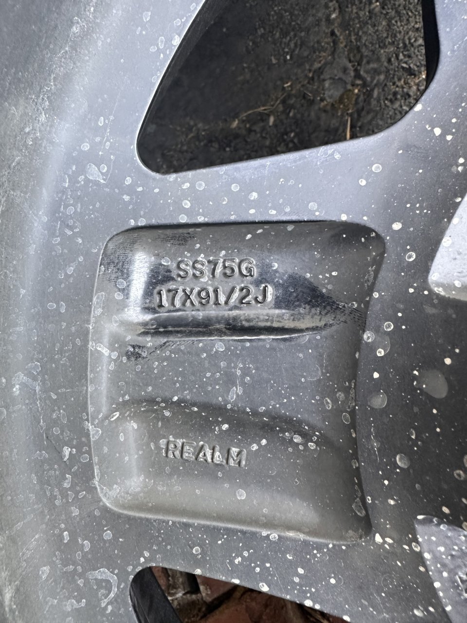

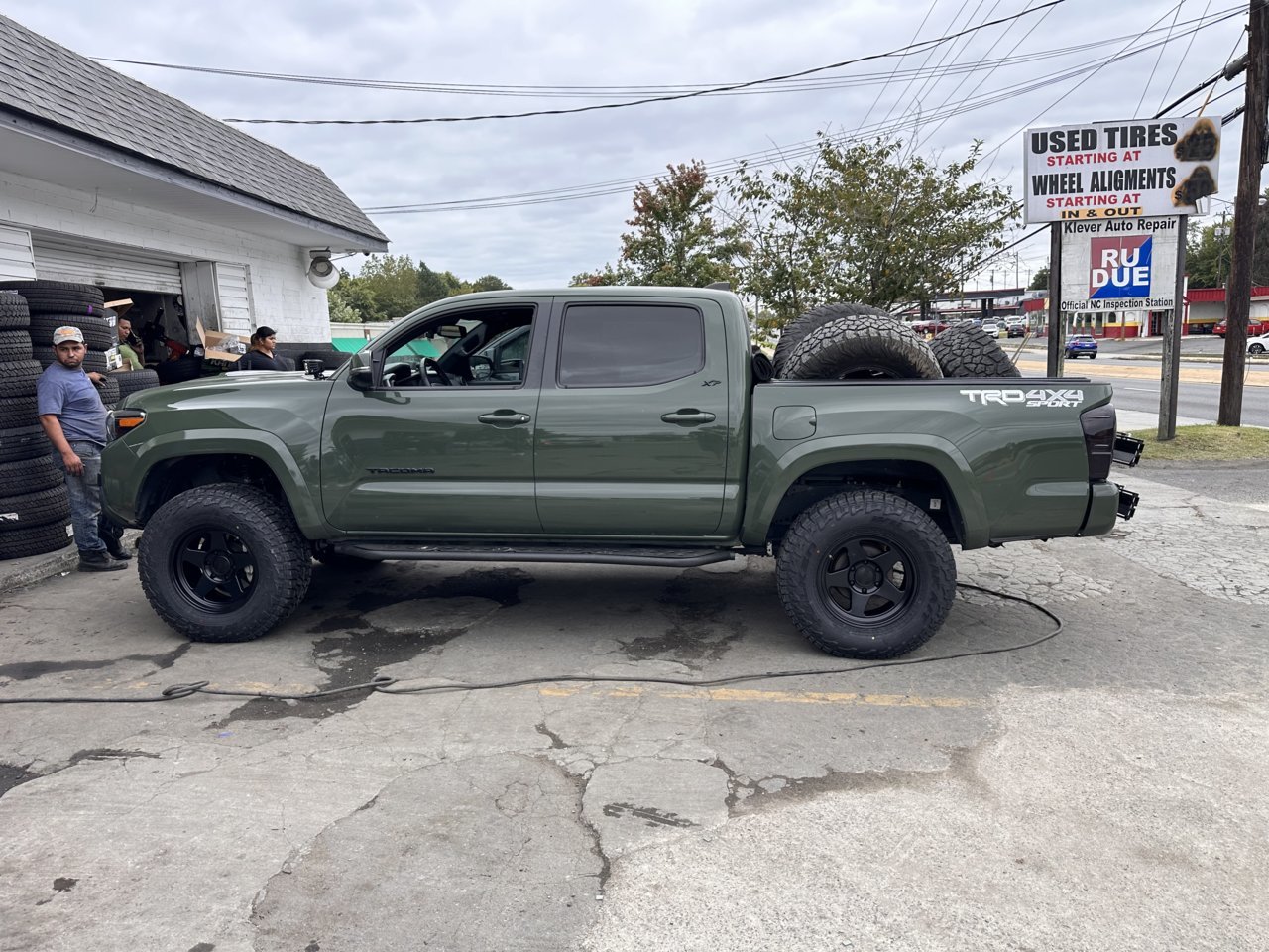

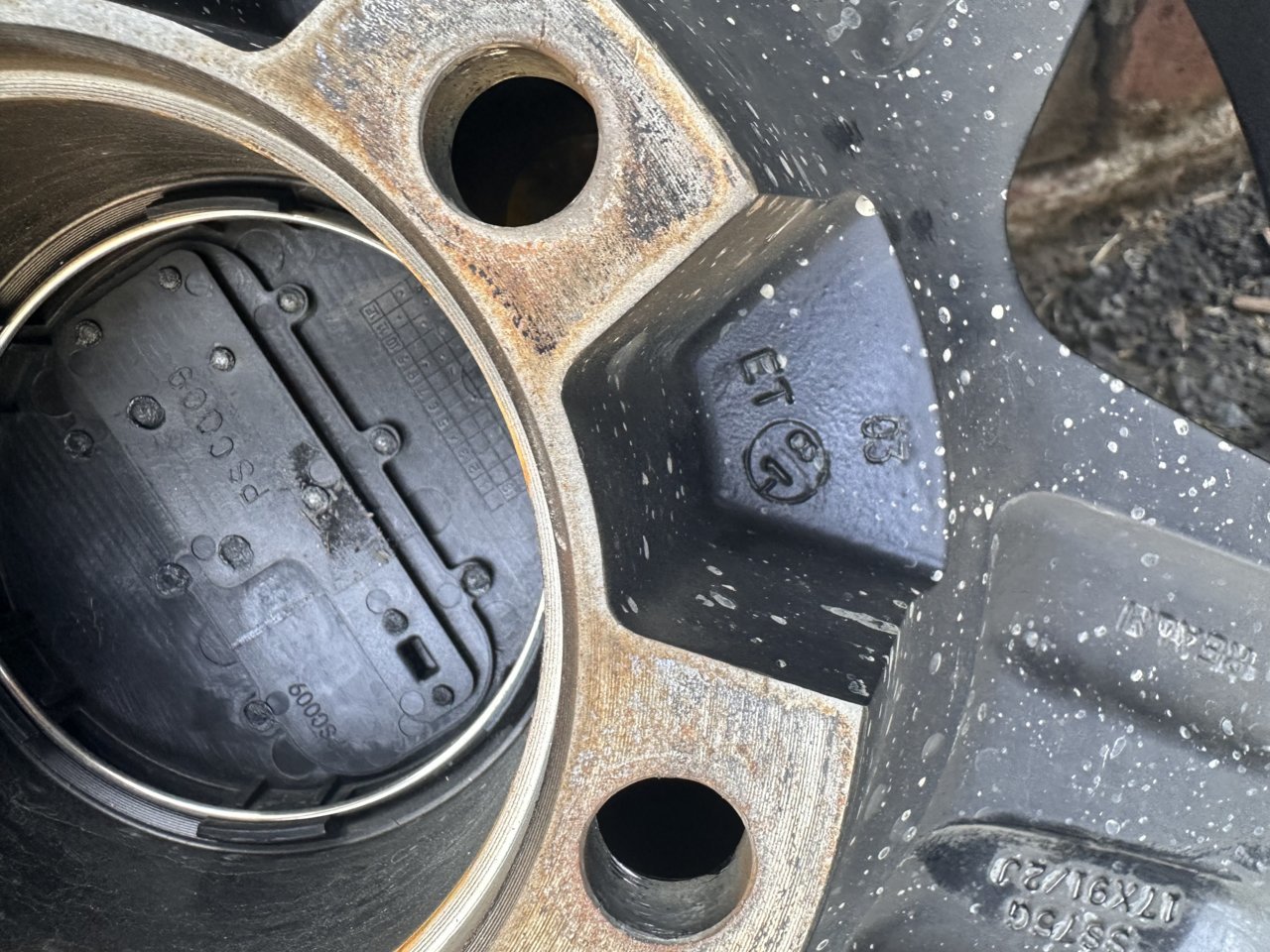

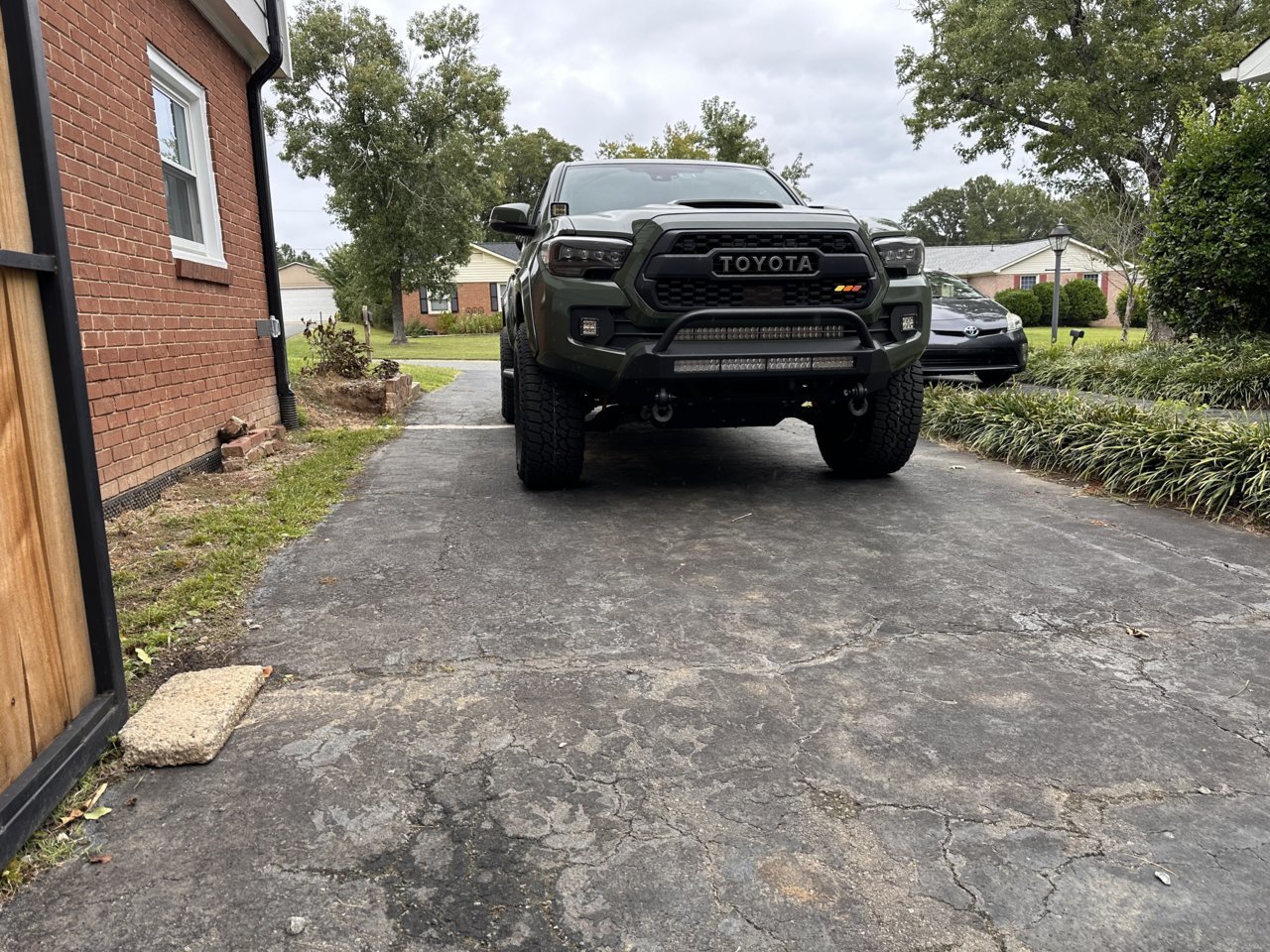

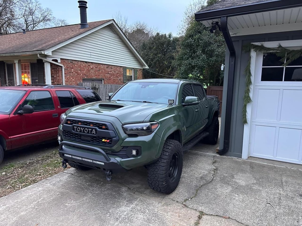

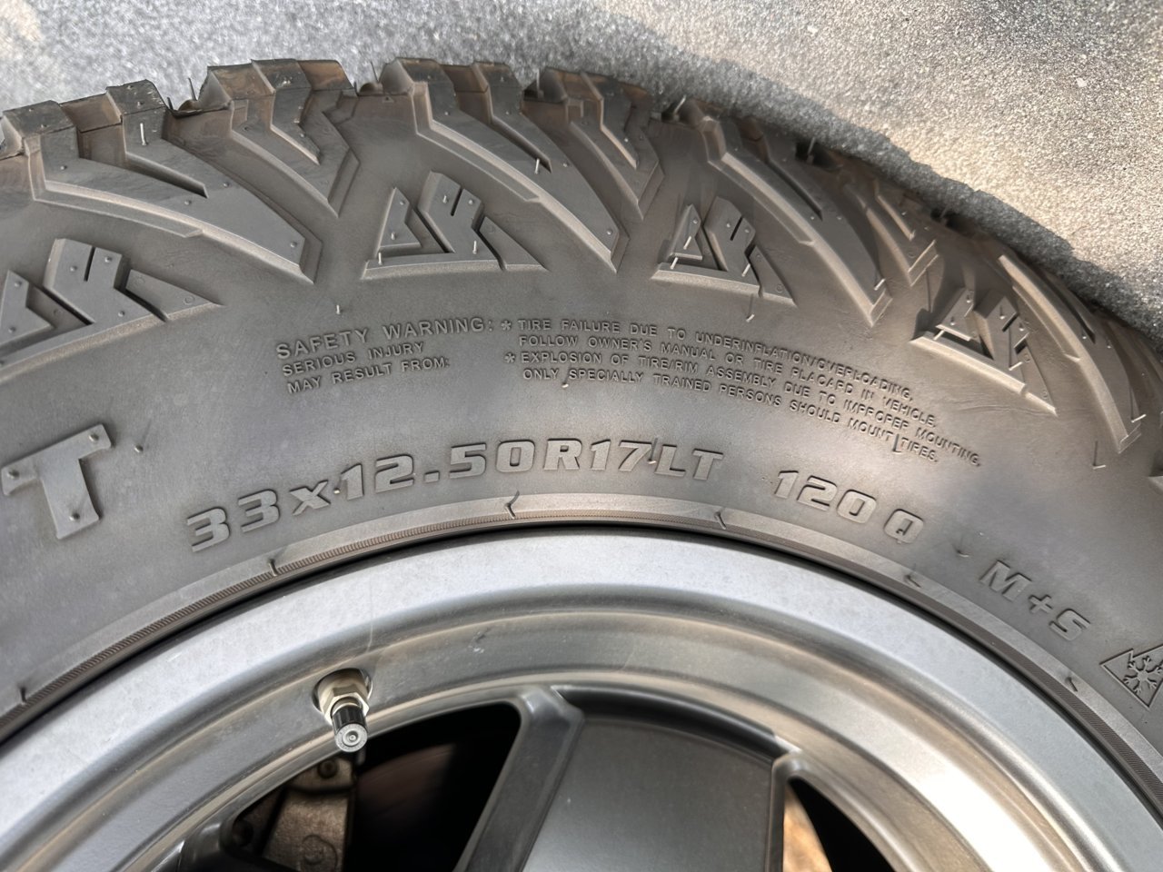

    Hey everyone! I have 2021 Tacoma currently with Black Rhino wheels and they are 33 x 12.50 R17 with a -18 offset.
    I am not wild about my tires poking out of the fenders and would really love to get them just flush with the fenders. That said I am struggling to find the right solution for the wheels. I likely will be dropping the width of the tires a bit as well. Probably drop down to a 285/70 or 75. Looking at the 4runner 17in TRD Pro wheels I think those might work but does anyone have a solid combo of sizes that meets the above criteria?
    I have a 3in lift, and the frame has been modded so I can fit just about anything that someone would reasonably put on a Tacoma.

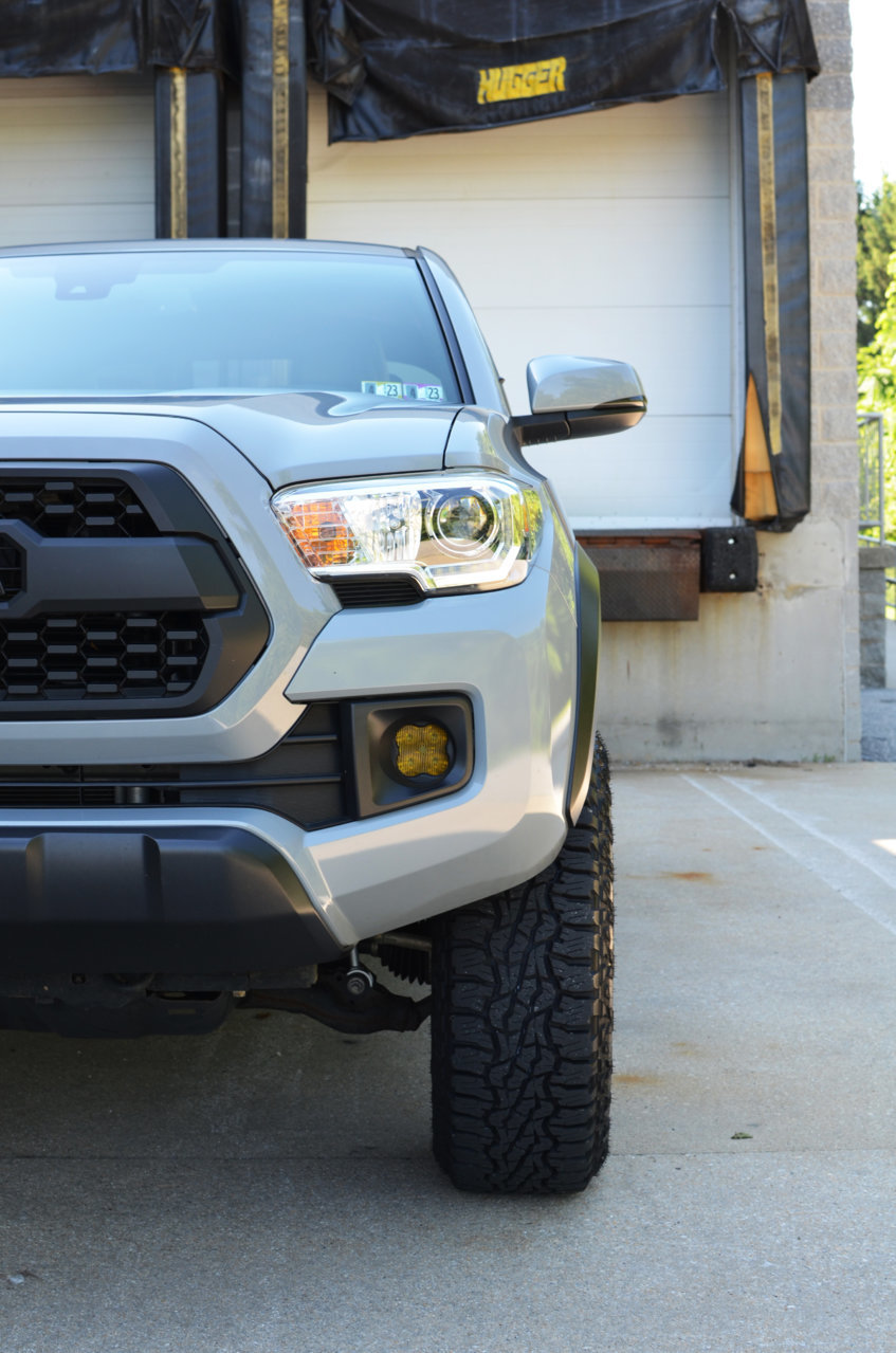

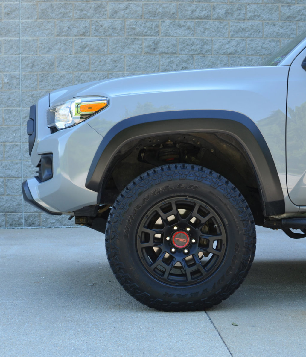

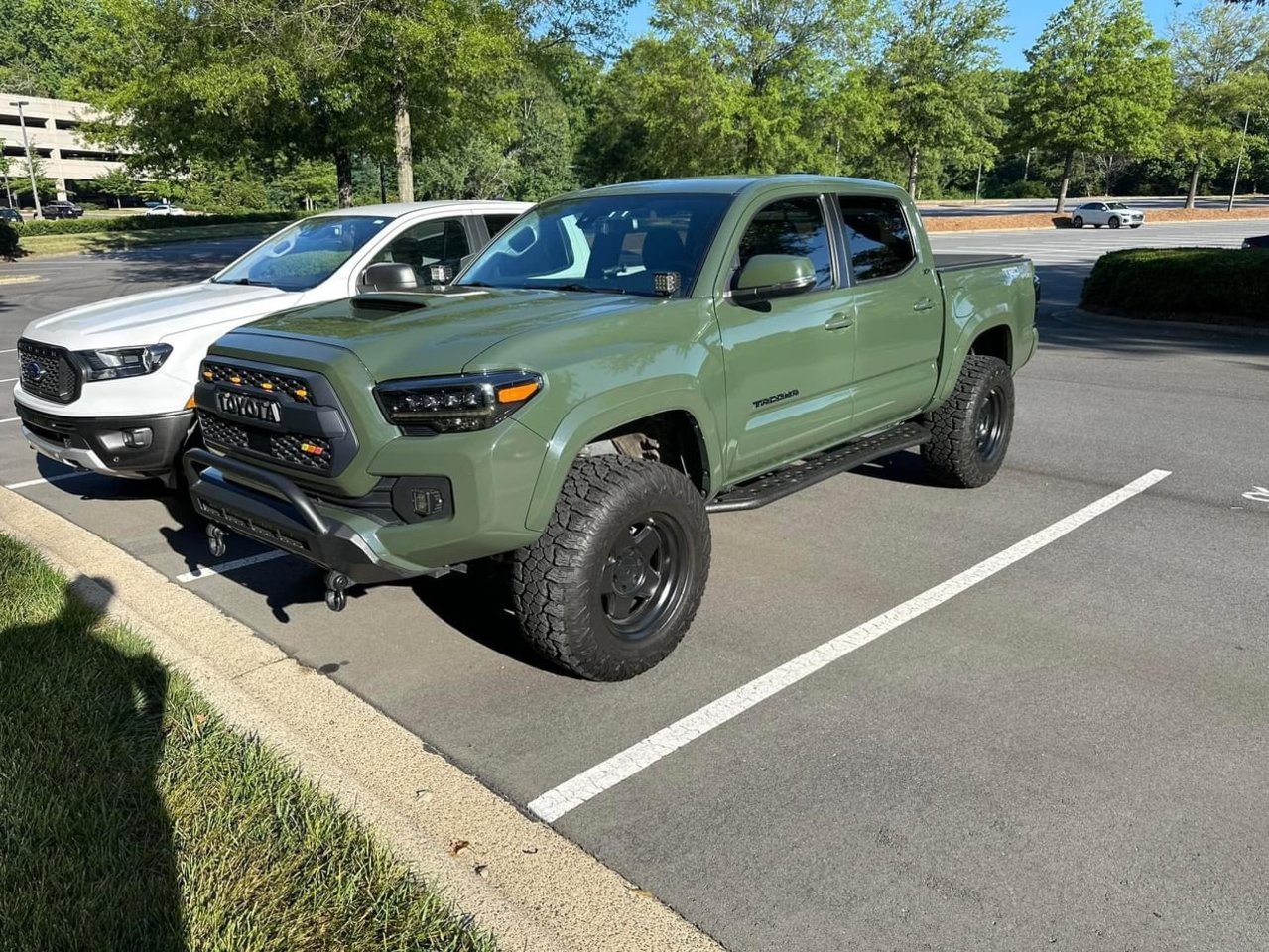

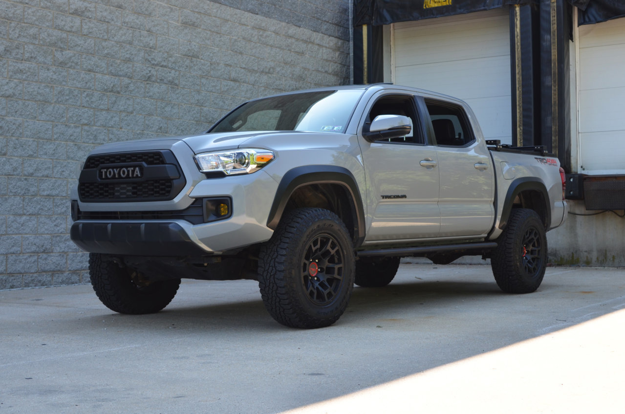

    You'll need a skinnier wheel with a less aggressive offset to be closer to flush. 8.5" wide wheel here with +0 offset. Flush with the tiniest bit of sidewall poke.

    This is exactly the look I want. So good. what wheel are you using for this?

    Dude that’s badassssss! Check if someone’s whiling to trade. I always recommend 0 offset and skinny 33” or 35”

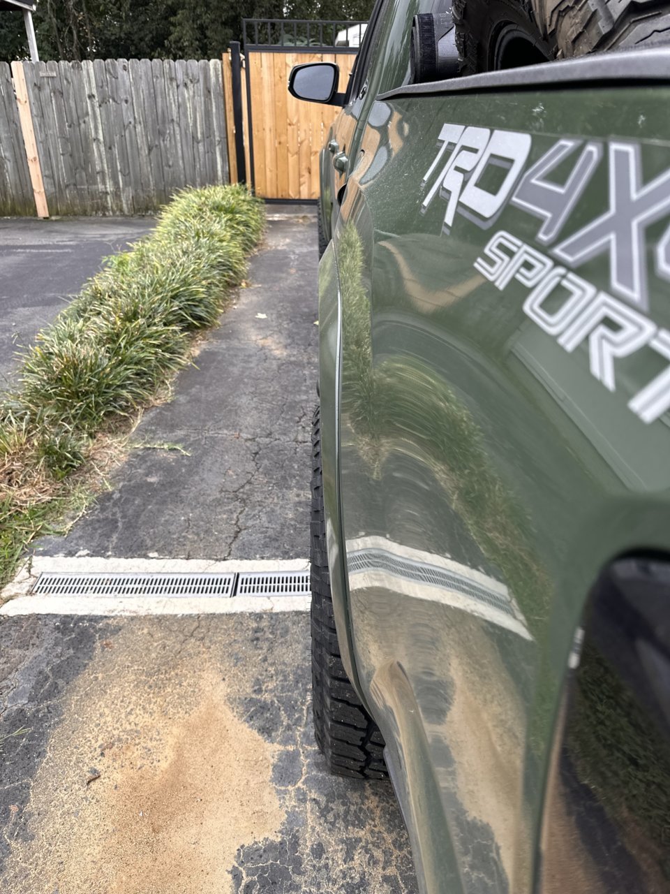

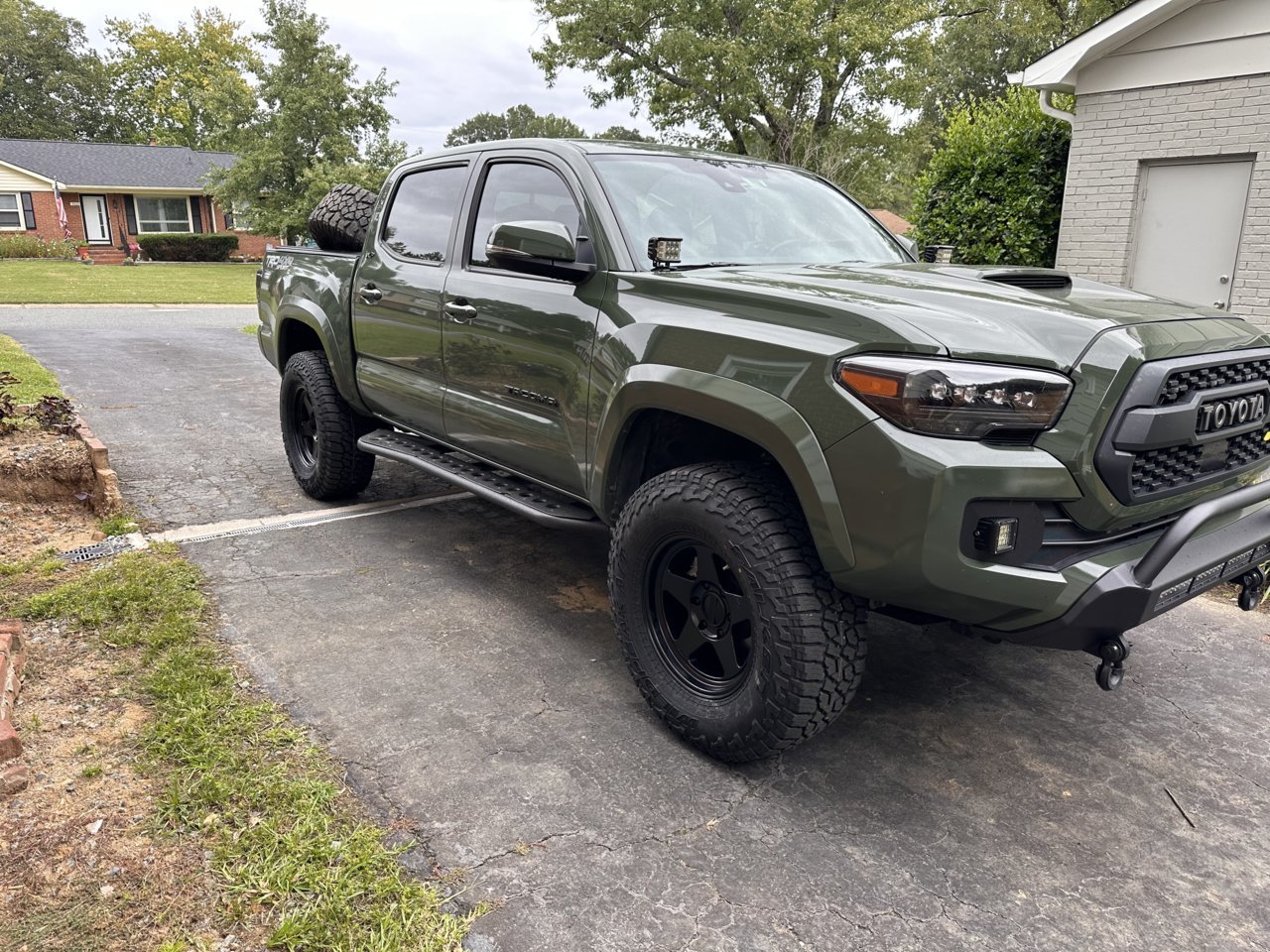

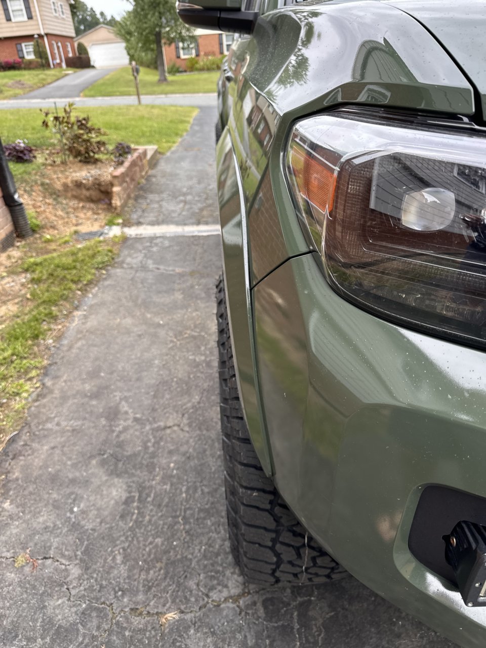

    Just wanna share an update and what I went with. I swapped out for:
    • Kansei KNP Matte Black - 17 x 8.5 ET0 - LINK
    • Falken Wildpeak A/T3W - 33" - 285/70R17 - LINK
    They sit perfectly flush (hella flush?) and are just awesome. I much prefer the flush look and since I kept 33's they still fill out the wheel wells properly. If anyone wants to buy the previous set I have them listed for sale now on the forum link below but here are the pictures of the new stuff.
