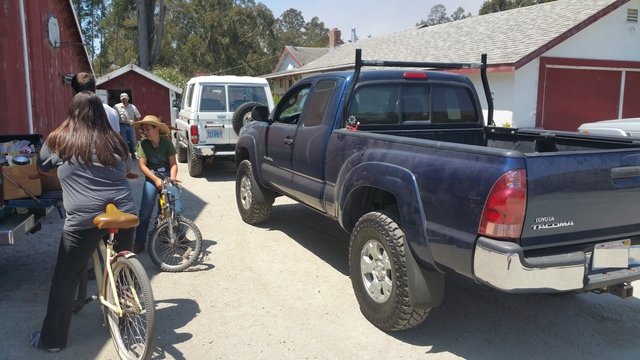

    I'm a little late to the party here, but
    I've got a stock 06 and I went from the itty bitty 215 70s that it came with up one size to the 225 75 Wranglers. Here's the look
    https://www.tacomaworld.com/threads/side-by-side-pics-before-and-after-2nd-gen-5-lug-reg-cab.368775/
    With the manual 2.7, there's a very noticeable difference in performance. Not so much that I'd go back, but it is significant. That said, if I bought another 2.7 5 lugger manual tomorrow, I'd go up to this size tire again in a heartbeat.
