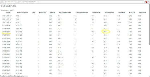

    Cooper Discoverer S/T MAXX 255/85R16s

    Kind of. :) For non metric tires you're correct. a 31x10.50 is 31" tall, 10.5" wide, 33x12.5 is 33" and 12.5" (more or less since tire makers are silly). Very simple. Metric tires, it's aspect ratio and I use the calculator :laugh:
