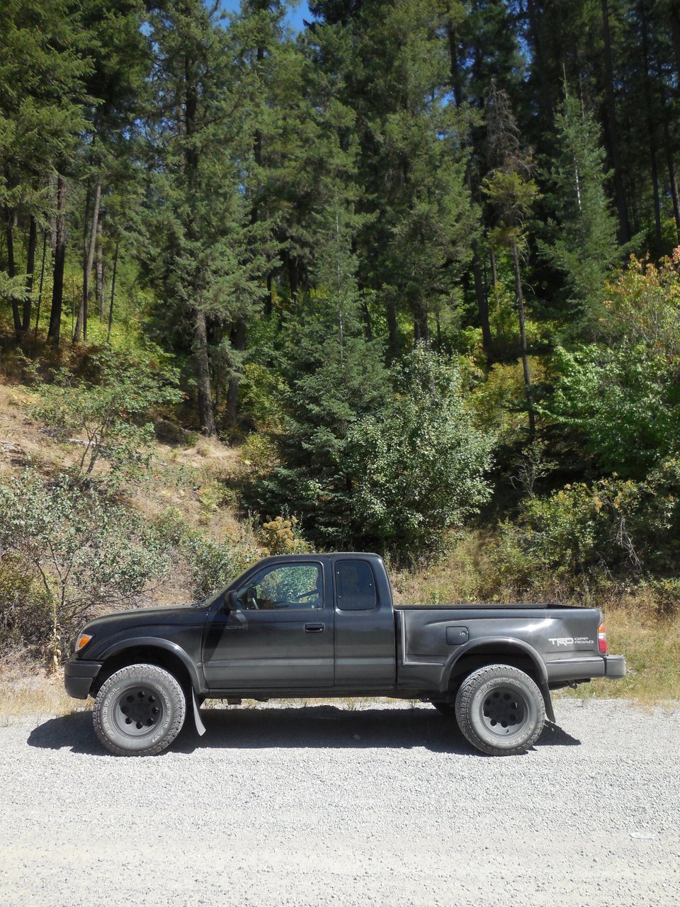

    Yep. But he said he didn't want spacers. I had 3.5" BS on my old 15x8 wheels and they stuck out quite a bit compared to stock - 3.75" would be about perfect for a little better stance.

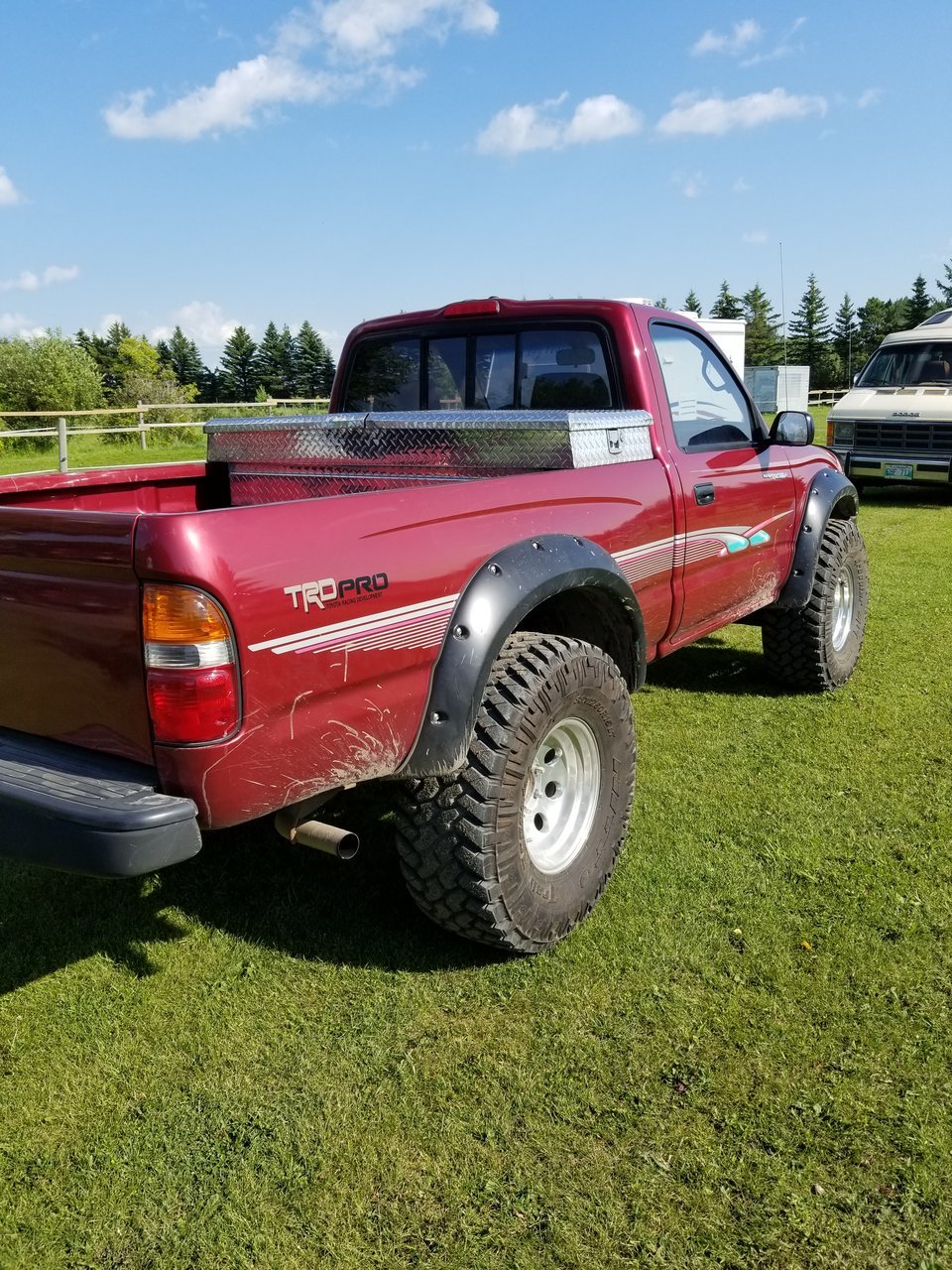

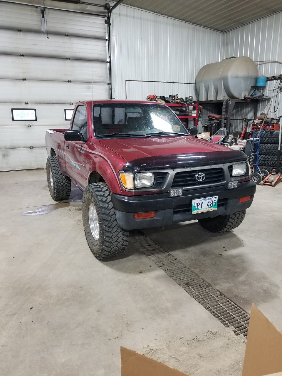

    I'm running 15x8 with 3.25bs and a 33 12.5 15 with no lift or controll arms but pinch weld and bushwhacker cutout 3" button flairs. I also had to move washer tank and bumper.
    It fills right to the edge of the flairs and rubs the frame at full lock. Right now I rub on the body but should be able to clear for 90% of wheeling with a 3" ET lift. It has some serious stance and the pic is before flairs

    thats a beaut. alright, thanks for all of the measurements. i definitely will get 33's later. i like the width too

    Np. Finding the rims is the worst part. 15 = PITA.. 16 = lots of options. The flairs kinda make it complete.
    I need new photos because there is a lot more done since then. If you dont mind a little extra width go with less back spacing (wider). True it's more wear on components but I like the look. I'm looking for floatation as well with 12.5"... in many applications a 33 10.5 16 or 15 will work better and than 12.5. You can choose rims to match the tire. 12.5 requires a 3.75 bs or less to clear the upper controll arm. Most wheels at 8" x 15 or 16 with BS at either 3.75, or 3.25 will work... stealies and some aluminum don't work in 15"because of caliper clearance. You have picked your poison when going with 12.5 wide by 15 ... 16" wheels are much easier to fit because of the dish on the rim clearing the caliper.
    It's up to you.. I don't have a lift in either of the photos and it's not wheelable at all. Without the cost of the lift this is the most expensive and limiting way to go in tire sizes without going lifted, MT, LT or SAS before .

    I think you have it backwards... the wheels provide the backspacing, not the tires :confused:

    I had those wheels in a 15x8 and they were great.

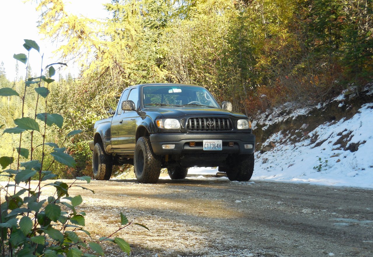

    Yep, I loved the stance they gave! They gave the tires a little poke, but not too much. This was with 31/10.5/15 General Grabber AT2's.

    Nice looking truck. When you mention a small amount of poke (wheel outside the fender well) that is what causes mud and rocks down the side of your vehicle. You can see in the second pic how the mud has collected on the mirror. Not saying there is anything wrong with this just mentioning it for others that may not think of it. I will stand by for the assault:crapstorm:

    Mus is fine. It's when you smash your own mirror off...

    Yep that's a good point! That's with front mudflaps too, but obviously they don't cover the area out past the fender flares. It didn't bother me, but my truck would often come home much dirtier with these wheels, and my tires did throw more rocks at my body.
    Funny story about that actually - with these wheels, every now and then my tires would throw up rocks and they'd land on my roof :rofl:
