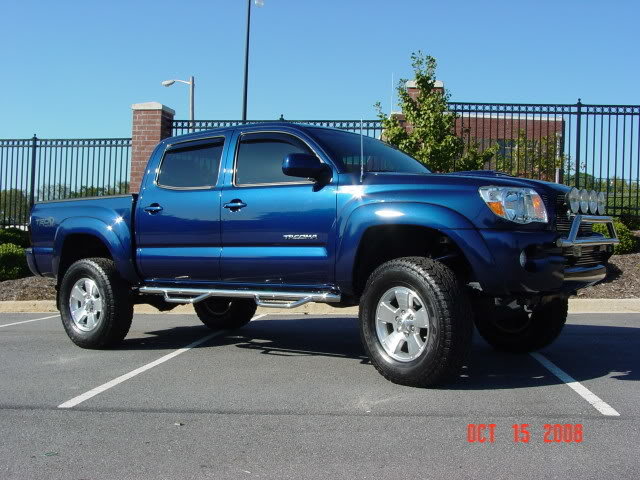

    They fit... you'll need spacers to clear the UCA's usually though.
    EDIT: sorry yes lift is a must.
    Heres mine on the stock rims with 285/70/17 KM2's

    Zarlyl, make sure when you do, go with the spidertraxx spacers, the tire shop tried putting some random ones on mine with the wheels and I had the worst steering wheel shake ever because of the 'hub-centric' balance. Either way I went to aftermarket wheels 2 days later.
    If you go with my tires, you'll need to take most of the black inner plastic fender out on the front. Be aware you will still occasionally rub the cab mounts, but to fix that is a considerable amount of labor.
