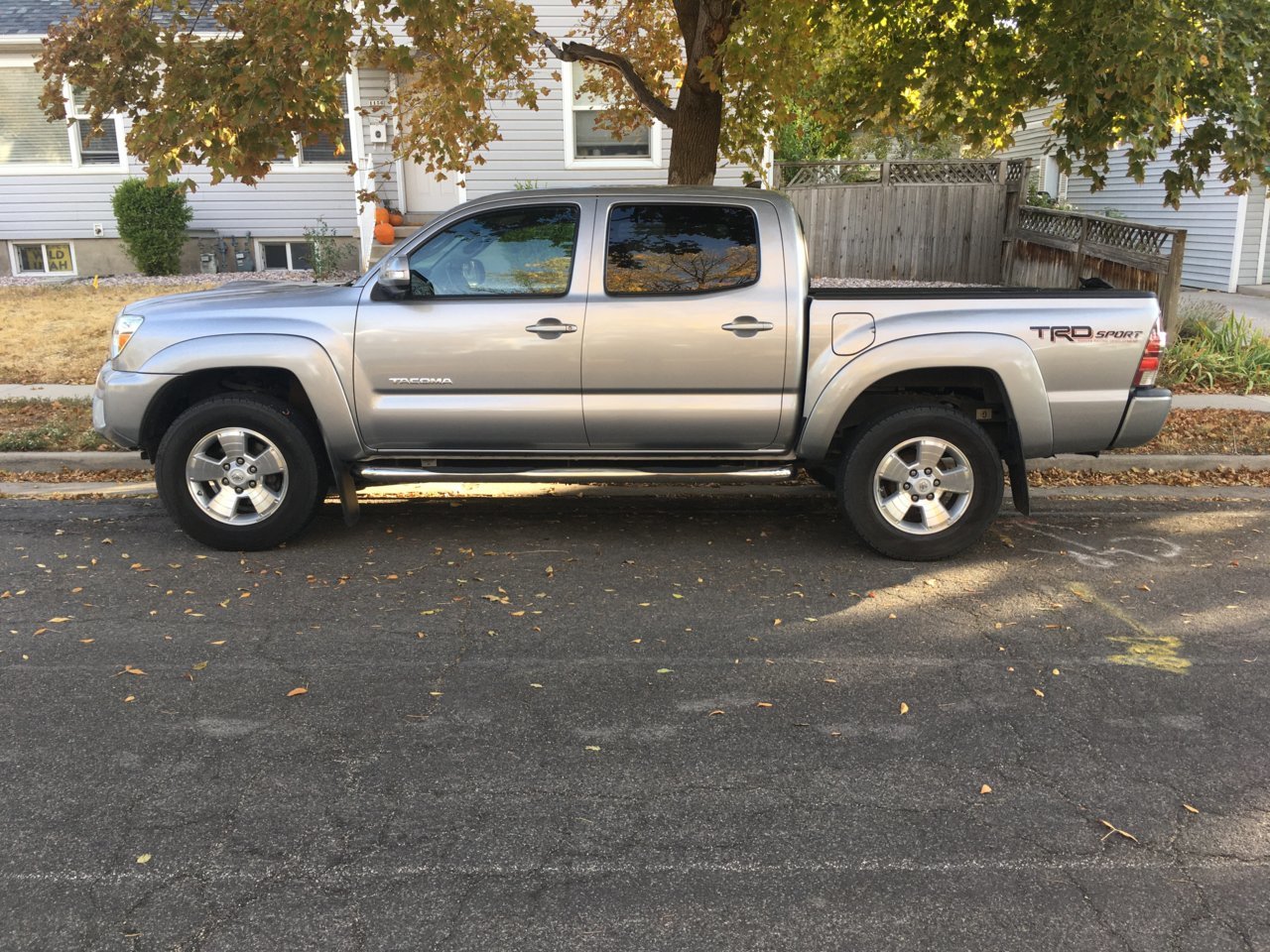

    I got a 2015 TRD Sport stock, looking to give it a suspension lift and add some bigger tires and smaller rims. I'm pretty set on going with 16" wheels, and I'd like some advice on what tire size to go with. I commute regularly and drive some pretty rugged dirt roads around Utah. Looking for something that will smoothen out the rough ride, won't be crazy loud on the highway, good in the snow/ice, and can handle the dirt, rocks and sand on the roads around southern Utah.
    Can ya'll post some pictures of your trucks if you're running tires in these sizes? Specs on your tire size and any lift height advice would awesome.
    Tires sizes I'm considering:
    - 275/70R16
    - 285/75R16
    - 295/75R16
    - 305/70R16
    - 315/75/16
    Tires I'm considering:
    - BF Goodrich AT
    - Falcon Wildpeaks
    - Yokohama Geolander M/T G003
    - Cooper Discoverer STT Pro
    Wheels I'm considering:
    - Motegi MR150 Traillite 16x8
    - Motegi MR149 MT6 16x8
    - KM717 Bully OL 16x8
    - Summit Offroad Stryker 16x8
    - Stealth Custom Series F5 16x8
    Current setup:

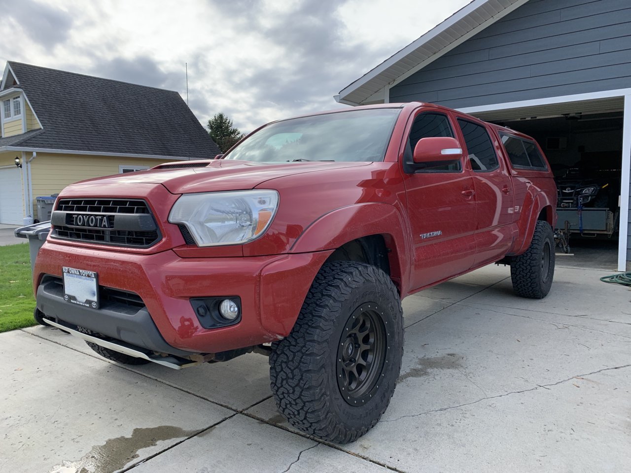

    On my 2013 I have SCS wheels, 17 x 8.5 inch Ray 10s with KO2s in 285 70 17 C load (51lbs).
    Icon Delta Joint UCAs. ICON mini leaf pack in the rear, 1.5 lift.
    22 inches from center of hub up to fender in the front, trimmed plastic bits in the rear of the front wheel well, on pavement no rubbing.

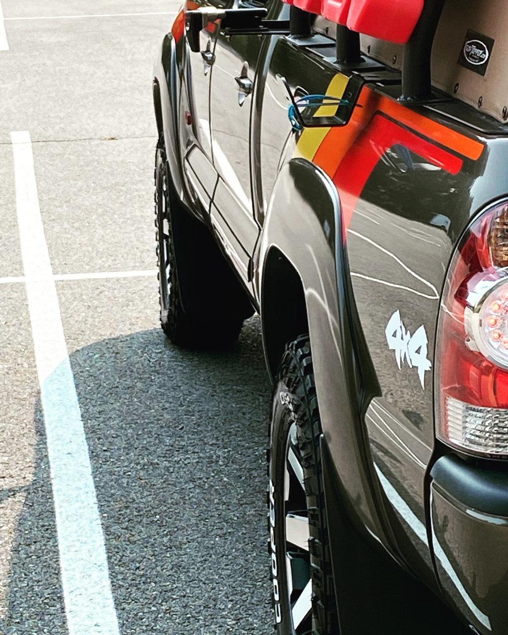

    3" ToyTec coilovers, JBA UCA's, Bilstein 5100's
    285/70/17 Nitto G2s 17x8.5 -10 American Outlaw Lonestar wheels. 3/2 Toytec lift. 8CF5F99A-A16A-4E7D-AAC1-32E766932EF1.jpg

    Nice! 285's are lookin good!
