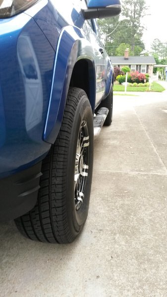

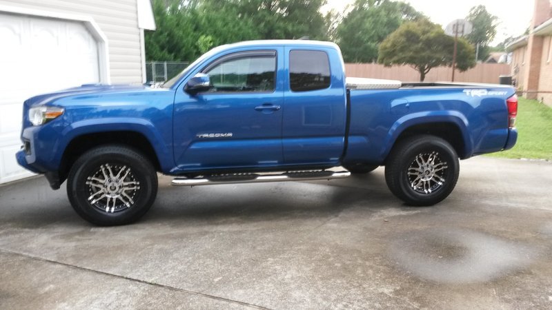

    I have 265/70/17 on 17 x 8 wheels with +10 offset. It brings tires out 1" more than the stock 265/65/17 on stock sport wheels. Zero clearance issues. I am looking at going to 8.5" wide with 275 tires. With this +10 offset it will add 1/4" width inside and outside. I have tons of inside room with 265/70 tires. I do not foresee any issues unless I go to 9" wheels. Still looking for the right package with 18" wheels and a lower tire profile (30.5" or 31" diameter tires). Just not thrilled with my setup. I have no plans of lifting. If I find some awesome wheels I may level the front.
