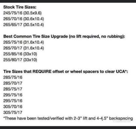

    I was just wondering if one could put an 18" tire on a stock trd pro vs the stock 16" tires and not have any issues?
    Thanks

    Limiteds have 18” wheels/tires. Not much sidewall but they do fit.

    That chart is very handy! Thank you
