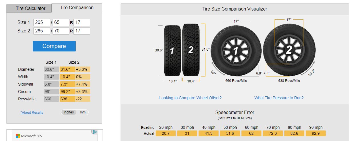

    Yes it does. You can input your current tire specs and then the new tire specs into that website and it will show you size differences. It will also show you the speedometer difference.

    Sep 28, 2021

    No it will not affect the speedometer readings. If anything it will be more accurate with the 1” larger tire.

    There is no difference in Speedo readings if going with 1” bigger tire size.

    Now, do I think it's a big difference? Not at all. But there is a difference. Just putting that out there.

    Yes you are correct, but stock Tacoma truck with stock wheels will run a mile per hour or so less then what’s on the Speedo. 1” larger tires makes it a much closer reading.

    Here's the quick math.
    31.5" / 32.5" = 96.9%
    At 65MPH your speedo should read, if it was correct before, 65 * 96.9% = 63MPH. So beware if you're allowed to go 10 over where you live, 75MPH on the speedo, 77.4MPH will be your actual speed.
