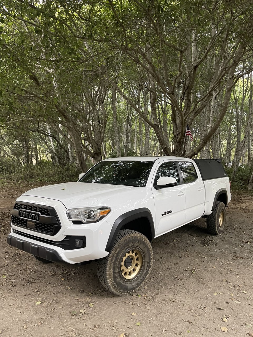

    DE642D20-2769-4D29-A1E1-5BCACB175AC3.jpg 265/75/16 Yokohama x-at on method 16x8 0 offset. IMO still look good. More tire for off-roading with 2” of lift

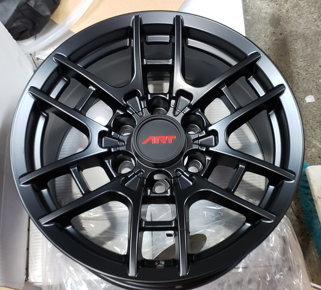

    I really like the look of these wheels but wanted 17's, so went with ART Replica 237's... 17×8 +5 offset in satin finish. I can not wait to get them on the truck in the spring. Waiting for tire supplies to replenish... no stock on Toyo AT3's around here.20211005_094147.jpg
