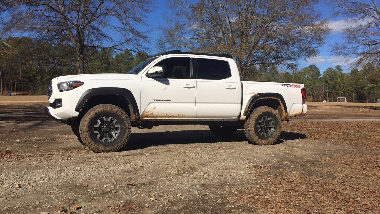

    Im running a 285/75/16 goodyear duratrac with 1.25 spidertrax on oem or wheels with 5100’s on stock coils and uca’s. No cmc and it doesnt rub. It will rub the uca without the wheel spacers. BAFED99B-0F84-46AA-8C92-7E2A61152DE2.jpg
