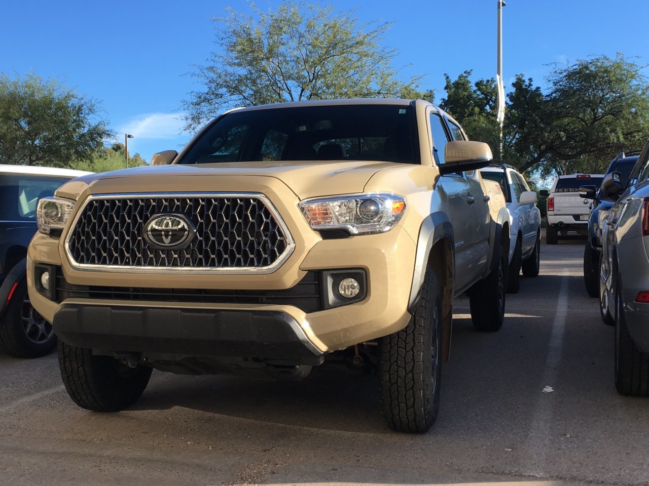

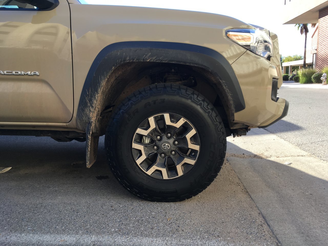

    I am getting ready to change my factory tires to LT235/85R 16‘s. Give me your thoughts on that? The factory tires are 265/7016‘s but they are P rated. The 235s will be narrower and 1 inch taller I spend a lot of time off road.

  18. Oct 19, 2018 at 10:54 AM
    #18
    Latrans
    Latrans Member
    Oct 17, 2018
    #269690
    13
    Al
    SE AZ
    2019 TRD OFF ROAD
    None yet
    Done! See picsA9A71D02-090C-49EC-B47A-7F3099E948EB.jpg994CD072-6547-4B8B-B627-82D54376175B.jpg
