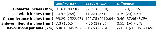

    Here are 285/70 17's on a prerunner (no lift) with a 1/4" wheel spacer. Generally if you went with something this size you would need to trim the plastic fender well and possibly a cab mount.
    Here is the comparison for that tire and a 265/70 17
    The tire calculator can be found in the drop down menu of the "Mods and Tutorial" Section at the top of the page.
