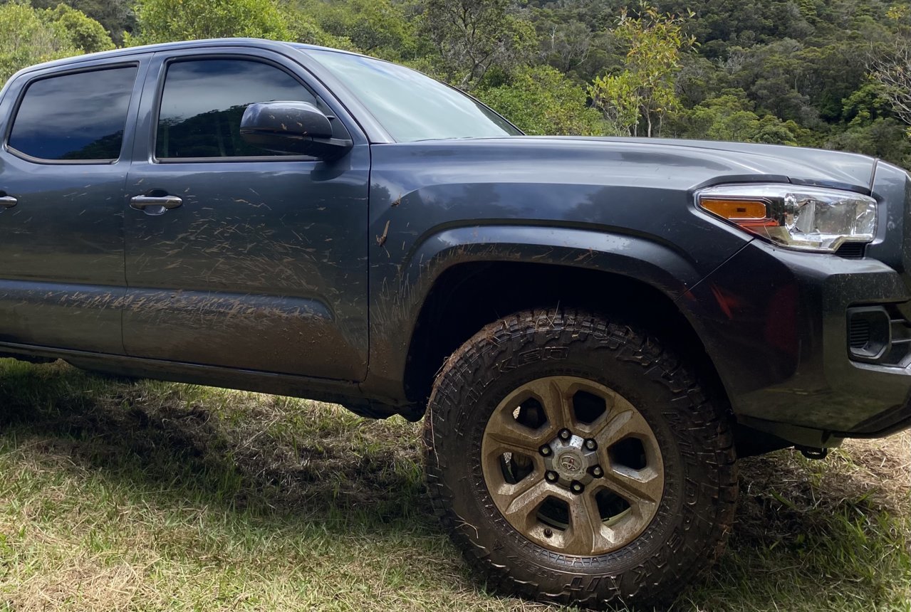

    Hey there,
    New here. I know there is lots of posts about tire size, etc. and I may be blind but can’t find a simple and clear answer on this….
    I am running 265/65/17 right now. I’d like to buy something bigger that would fit and look good right now, but also work and look right if I added around 2-3” lift/levelling kit.
    Any advice would be greatly appreciated!
    John

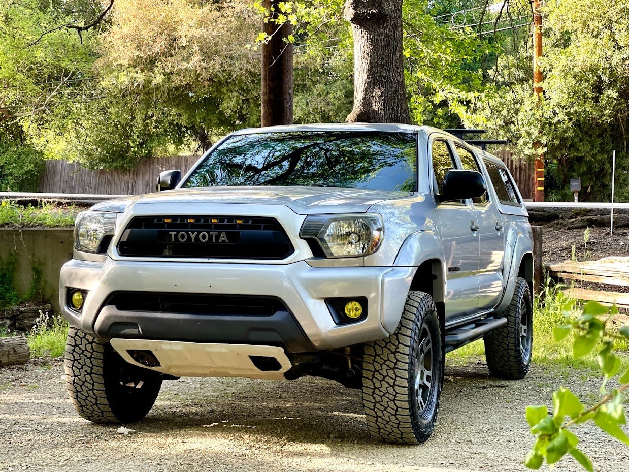

    i know this is a 2nd gen, but this is with a 3" lift.
    265-70-17 will still look good.
    but i would recommend the 255-80-17 tires. 33" tires that dont require too much work to make them work.
