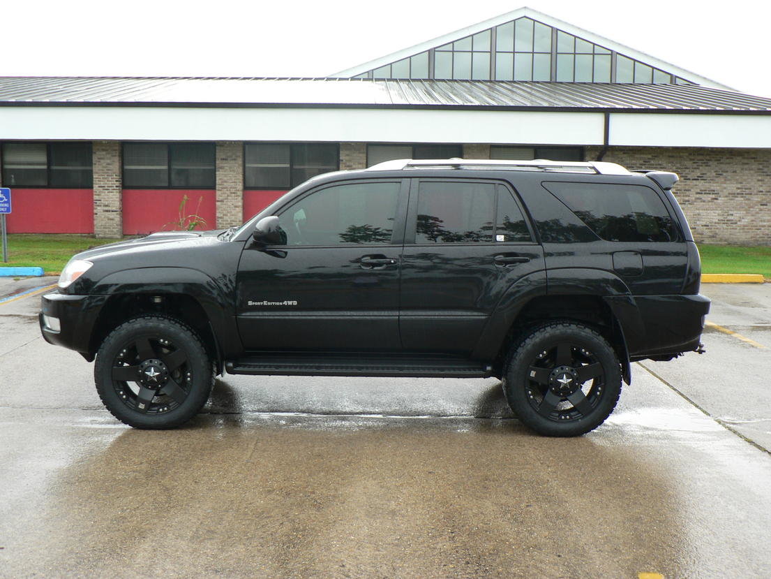

    What are the dimensions of this tire? My stock are 265/70/16
    21540d1254695877-post-pics-your-t4r-20in_48184a1394cd6f4f88a6f353ee94fed02ddbc7f3.jpg

    265 is the width,70% of the width is the height,16 is the rim size

    265mm= 10.43" wide
    70=70% of 265= 185.5mm= 7.3" sidewall height
    7.3"x 2= 14.6" + 16" rim height= 30.6"
    30.5x10.5"x16"
    If you want to know what the size of the tire in the pic is i have no idea.

    I'm gonna guess 285/50/20
