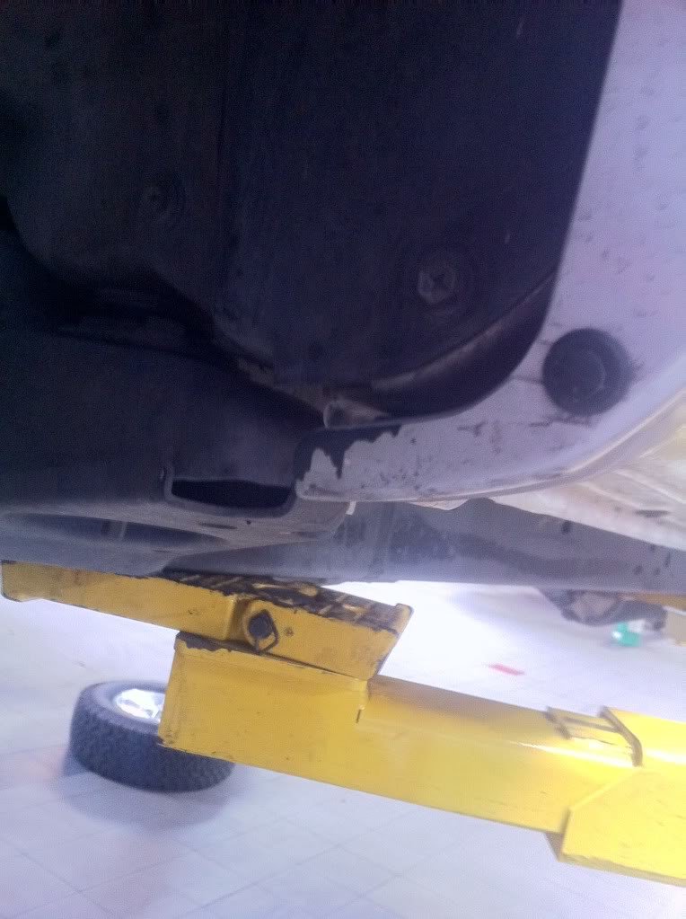

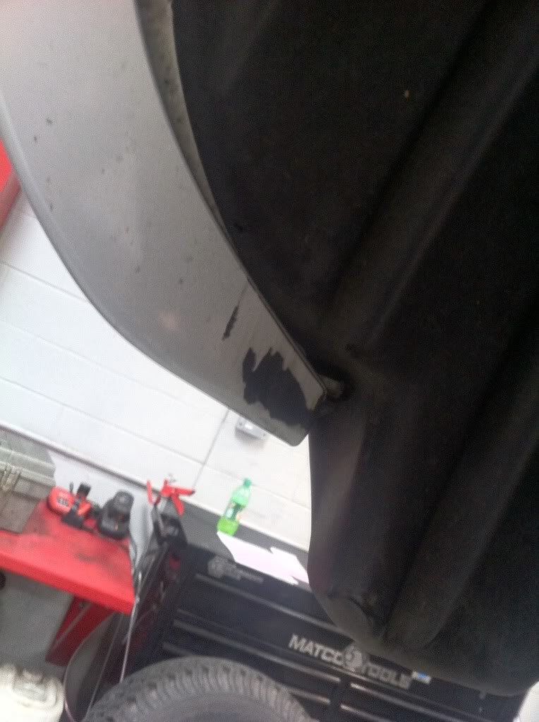

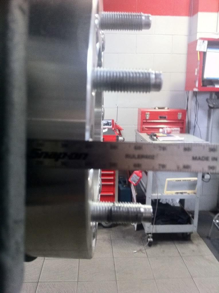

    Workin on a customers 07 taco w/ 285/75/16. He's got a 38mm wheel spacer on stock alloys, and a 2 inch spacer lift. Lots of room between the UCA and sidewall, but tire rubs on sharp turns.
    6b426339_f093bec7f41ff29f19e67a1daa4ffca9412d140e.jpg27e7eda8_962a152a446617578de47d4e12d62a520d86d416.jpg08e1bd45_b8bdc1716e41aec1ce5dc049e7e4d12ae3d574f9.jpg

    How bad is the rubbing(at full turn)? and what is it that rubs?

    The corner of the tread rubs the frame

    Looked at it again today, it also rubs on the flares
    6b15c691_0d344663f93e4da0fa446b90c9953dc683dc004f.jpg69787a66_35b60ad3c5ea162b93fc8e70dabd3bde0f61d0af.jpg

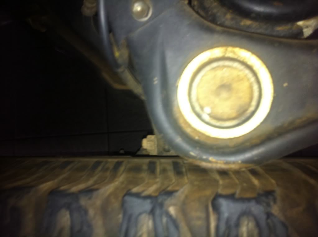

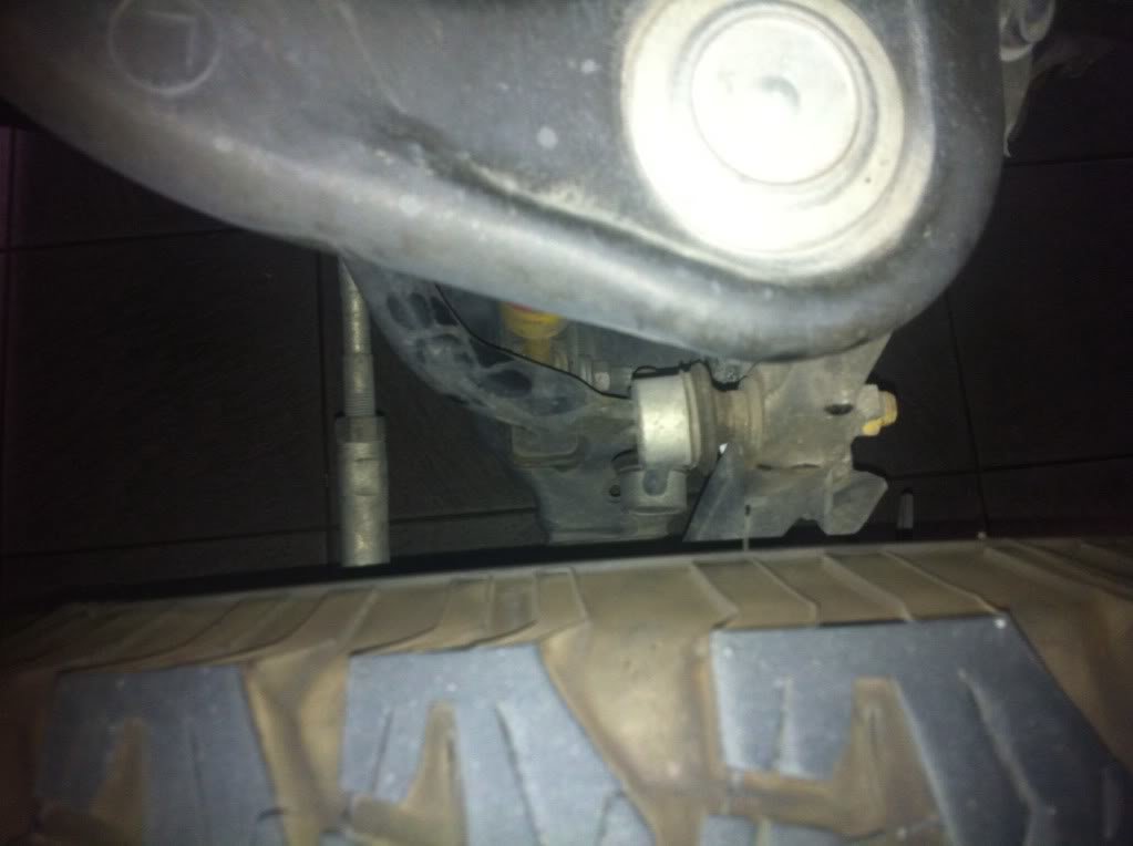

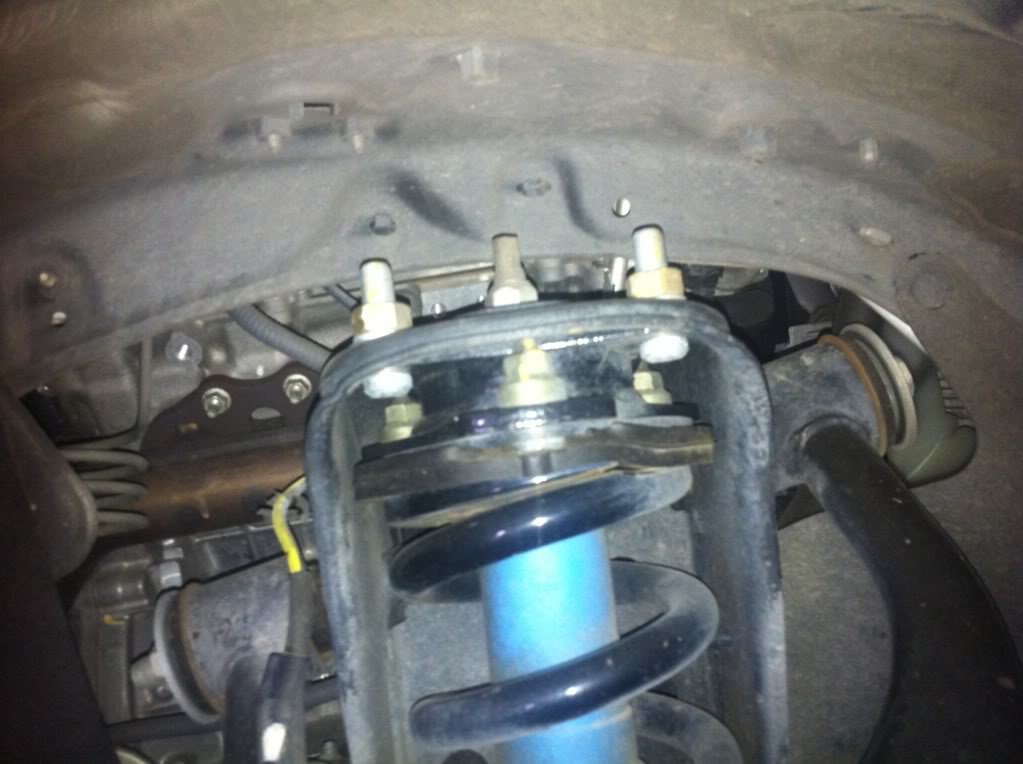

    Another taco with 285/75/16 is in the shop (this ones a tacoworld member) stock alloys. No wheel spacers
