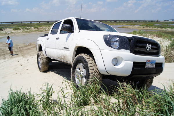

    Ah i misread your original post, IIRC 265 is the largest you can go on the base sr5 rims (someone correct me if im wrong) Have you thought about getting a set or trd offroad or sport rims off of craigslist. I have 285's on my trd sport rims

    BTW your truck looks awesome! I'm guessing OffRoad and 4x4 or OS it just OffRoad

    265/75/16 is the biggest tire you can go on stock suspension, you can get the billy 5100's set them at 2.5 and you'll be able to run 285's
    Thanks man, yes offroad 4x4 :D
