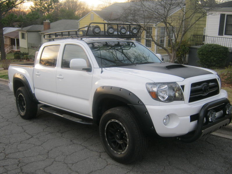

  17. Sep 20, 2012 at 11:17 AM
    #17
    ROAD DAWG
    ROAD DAWG Well-Known Member
    Aug 13, 2011
    #61655
    255
    birmingham,al
    10 trd prerunner
    debadged,procomp 7105 wheels,,kc slimlites,n-fab light bar,predator step bars,baja roof rack and light cage,hella 500 black magic,5100's(f/r) @.85,tsb rear,nitto terra grapplers(265-65-17)
    looking to go from stock 265-65-17 up to 265-70-17.wheel is procomp extreme(7105) 17 x 8 with 4.5 bs and 0 offset,i'm not lifted and no tsb rear..daily driver 2010 trd sport 4dr sb...i'd like more tire but i don't want to deal with VSC issues or tire rub,i have bushwacker pocket flares and no mud flaps
  18. Sep 20, 2012 at 5:01 PM
    #18
    TexasTacoma37
    TexasTacoma37 Well-Known Member
    Sep 3, 2009
    #22227
    31,174
    ^^^ you'll be fine
