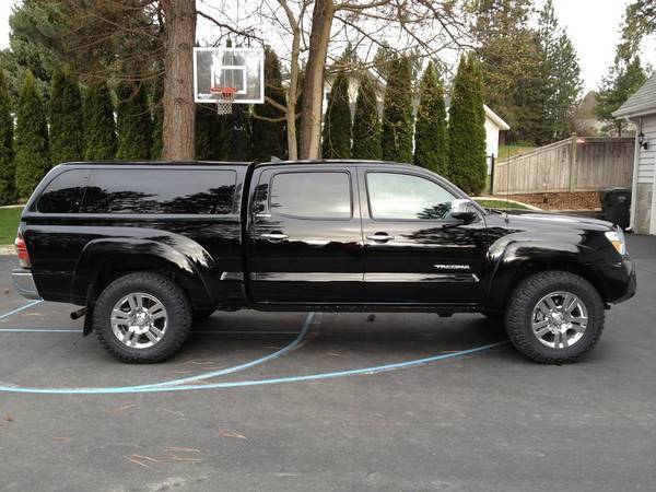

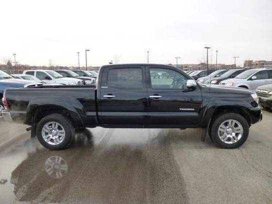

    Hi, I researched this topic quite a bit. I have a 2013 Toy Tac Double Cab Limited 4x4. The truck is stock with no lift. I just had 275/65/18 installed at Discount Tire. We test fitted the 275/70/18 and they were a bit large so we dropped down to the 65. Discount Tires was great and took the time to do the test fit. You can research all you want but if you are trying to get the largest tire that will work I recommend the test fit. I did take off both front and rear mud flaps from the front wheel wells and I also detached the wheel well plastic and pushed it back as far as possible and reattached it to create more room. It worked well and you can't even tell I did anything.
