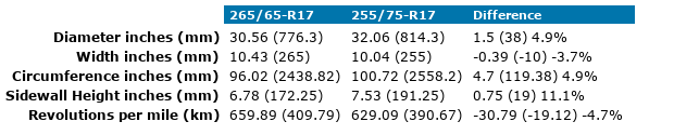

    dumb question...a friend is selling some BF Goodrich 255/75R17 tires off a stock jeep. Will they fit my stock 2010 Tacoma Dbl cab 4x4? It currently has 265/65R17tires. That doesn't seem to be much different.

    Yes
    Very slight chance of a rub at full lock
