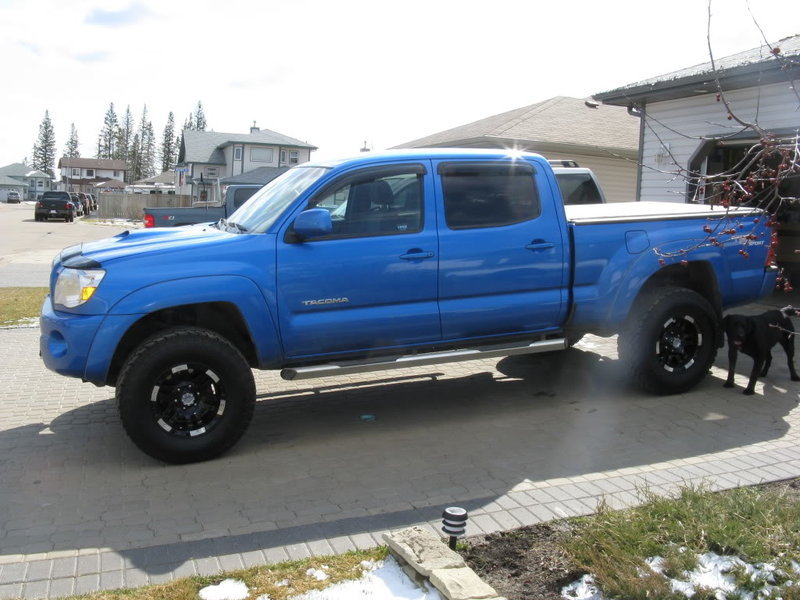

    hey guys i am wanting to get 32"s on my truck rims are 17's. but am having a hard time knowing which ones are that size. would 265/75/17 be 32" i want to keep with 255/__/17 or 265/__/17 thanks for the look

    A 255/75/17 is basically 32.2" and a 265/70/17 is a little under 32".
