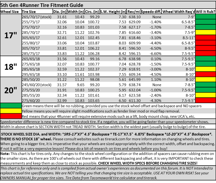

    104556d1386611703-going-bigger-5th-gen-t_0ddcf42c6aae00e011783b6a0eb4f29559c8ad1e.png
    I grabbed this from 4Runner forum, this is SUPER helpful and most people's question can be answered.
    But sadly it's only for stock wheel fitment, I used that above chart and bought the stock size tires but with -10mm offset, and they rub big time consider OEM offsets are +25mm something like that.
    It would be super nice if we had a Tacoma version of this, or even better, adding offset, as another parameter

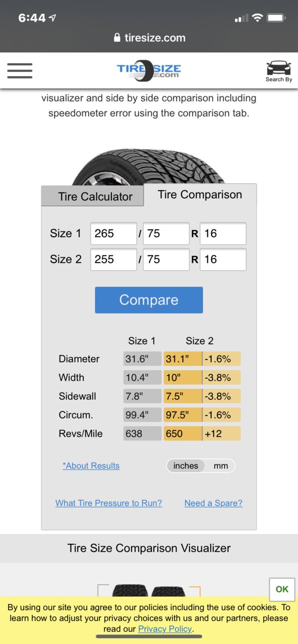

    not true. I have both :)
    255/75/17 is skinnier by 0.5” but it’s taller by 0.5 from 265/75/16. So smaller is really dependent on which part you are thinking about. 265/75/16 actually equates to 31.6” if that really matters…it’s trivial
    the first number is the width, second number is the sidewall with, 3rd number is the wheel diameter

    But, you said “255/75R16
  15. Sep 9, 2022 at 6:45 AM
    Junkhead
    Junkhead TRDude
    Feb 27, 2019
    #284671
    15,685
    Serge
    Prince George, BC
    Black 4x4 Sport MT 2018
    Some Serious Tires
    .4” narrower and .5” smaller :)
    Edit: I get it now, I think you made a typo in your original post.
