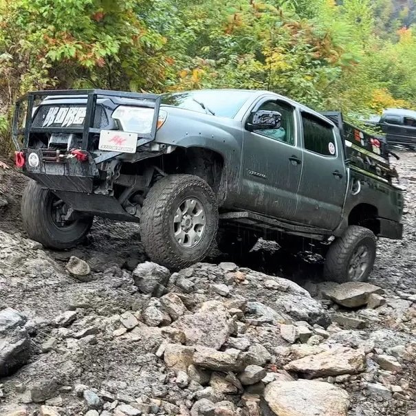

    I'm on 255/85r16. 2.5 inch lift, no cmc, but fender flares, liners and bumpers are long gone IMG_20221004_105513_714.jpg

    Love it! I’ve been running without the fender flares for awhile.
