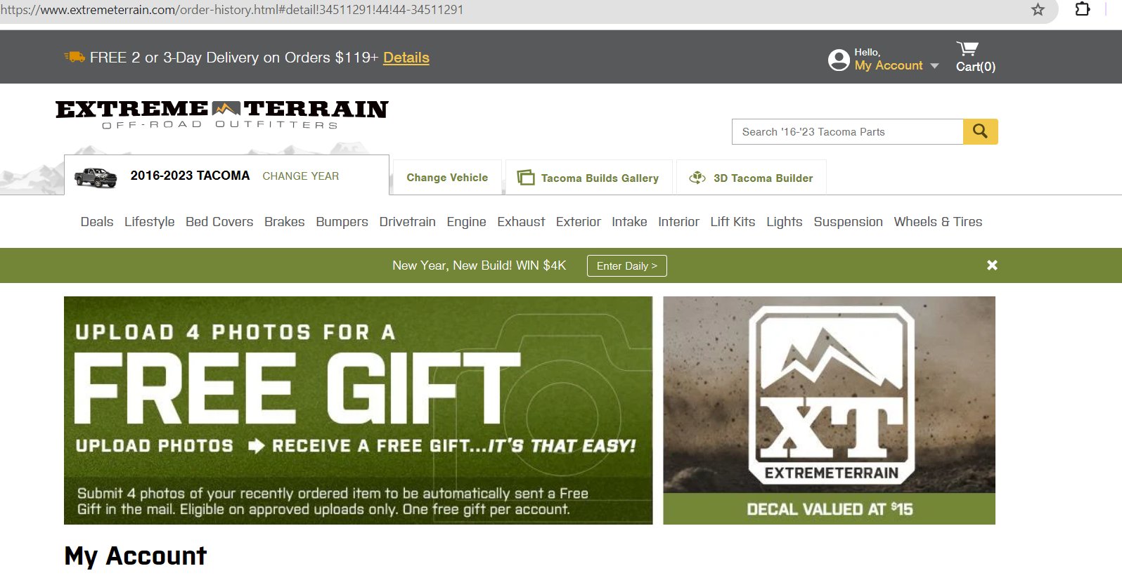

    Yeah unfortunately their site does not have the Tacoma listed in their drop down menus, so I can't use them.
  18. Jan 19, 2024 at 3:21 AM
    #18
    RetJetFxr
    RetJetFxr Well-Known Member
    Dec 28, 2023
    #440409
    79
    DELCO PA
    2023 Ice Cap Limited: 2" Lift using Bilstein 5100s and 2" rear spacers (maintains rake), TRD Pro 17 x 7, 4mm offset rims, and BFG 265 65R/17 K02 tires. Tinted windows (30 front/5 back), Weathertech window deflectors, chrome tailgate letters, raptor lights, front tow shackles, and red painted OEM skid plate
    Yes, they do have Tacoma. Look again.
