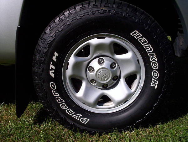

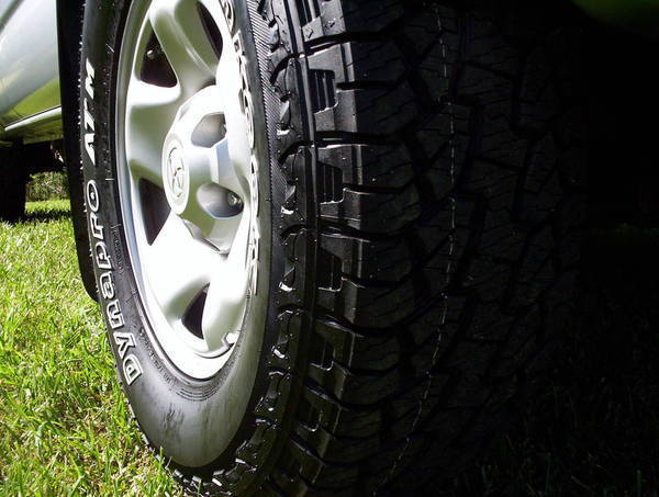

    Personally I run P-metric tires. Hankook Dynapro ATM in P265/75-16 weighs only 40 lb. It's a very good AT tire that also behaves well on pavement.

    Thanks Ken -- I have had the Hankooks in the back of my mind. Everything I've read says that they're lightweight and quiet on the highway.

    I'm running the Hankooks too. Love them. Good traction and light weight. Also look pretty aggressive.

    I have the Hankook Dynapro ATM's 265/75/16 P-metric.have only had 1 week on my 09 access cab v6 auto sr5 so the milage check is still out but I will be filling up on Sat. but at this time I see no loss of mpg as of yet.
