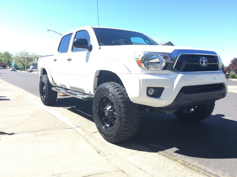

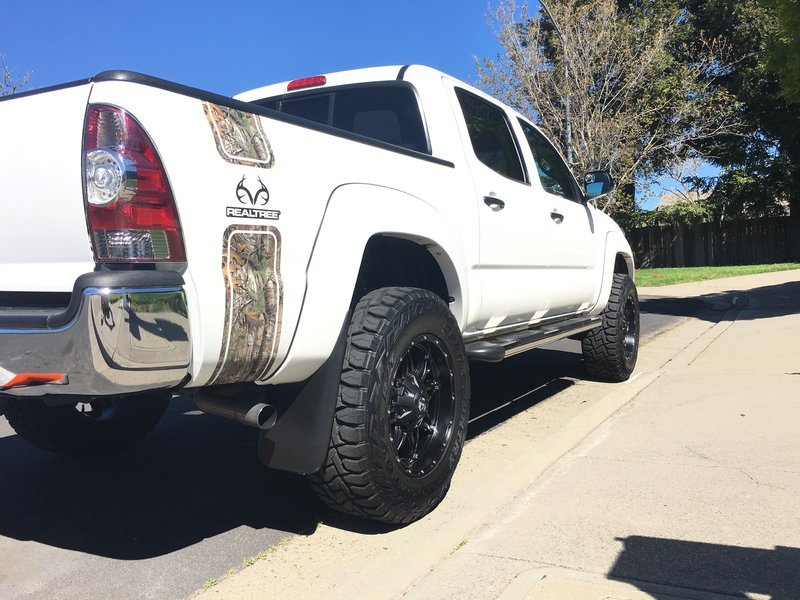

    I'm running Toyo R/T 285/65/18 on 18x9 Fuel wheels with -12 offset. Had to do the body mount frame trimming.

    What lift setup you running? My wheels are 18x9 also but with 0 offset.

    Rough country 3" front 2" rear
