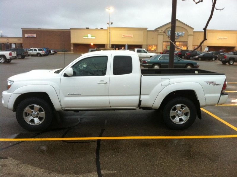

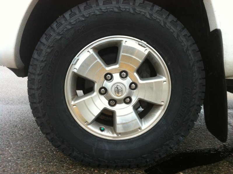

    Here they are...sorry for the crappy weather, blame Sandy. Hope these give you a decent idea of what they look like.:D

    Thanks for the pics, just ordered my Hankooks today.

    MUCH better.... :D
