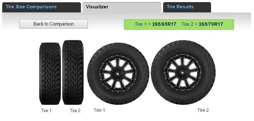

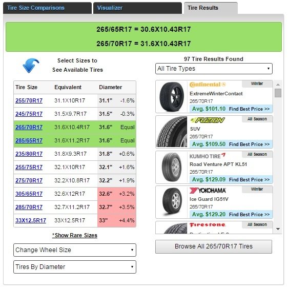

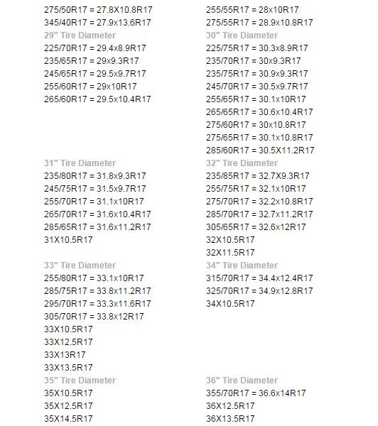

    ...or thereabouts. tire1_zps0pyp2f7e_fc2a918b9652988c00d9ad77721bd3ddad05e649.jpg

    Sorry I'm new to all this. But I want to fill the tire wells more (height wise).

    Splitbolt is that the size you have on yours now?

    No, I have 265-75-16.
    Same height & width as a 265-70-17.

    As the others have said, 265/70/17 is the size u want...

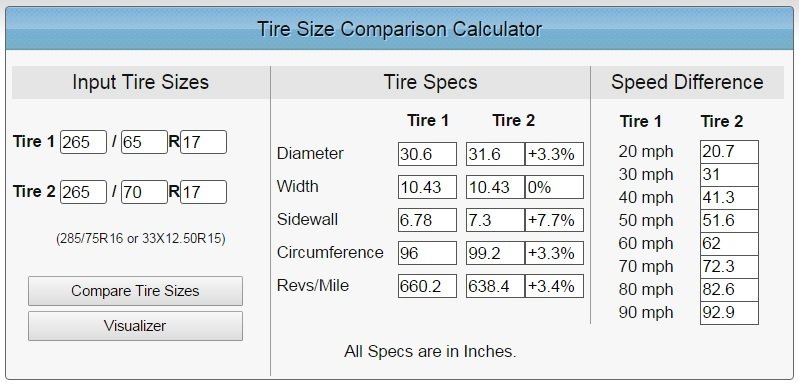

    or you know you could have used the link at the bottom of any page on TW :)

    I already used the calculator. I was curious if any else had already put this size on a 2016 and if they had any rubbing issues. Trust me I've been digging into the site to find an answer before posting the question but haven't had any luck so far.
