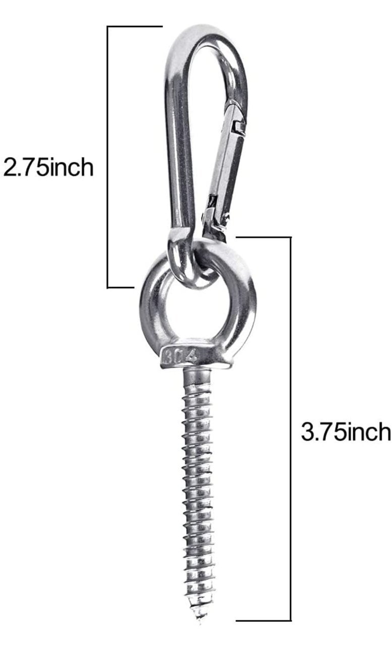

    Yep. I built it on the ground, then put the chain mounts into the studs and attached the chain to the front rail. I used a bit o geometry to cut the chains to length for close to 45 degree angle. Once the chains were attached I could figure out level and then bolted the rear rail directly to the studs with some timberloks.
    Mine is built for two sets of tires for my BMW so my measurements may not work for you but if you want them I can measure for you.
    Here's the hardware kit used for the chain. Meant for hammocks but rated to 1400 lbs.

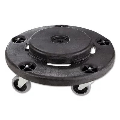

    If you’re only going 4 high, the Rubbermaid trash can dollys work great…
