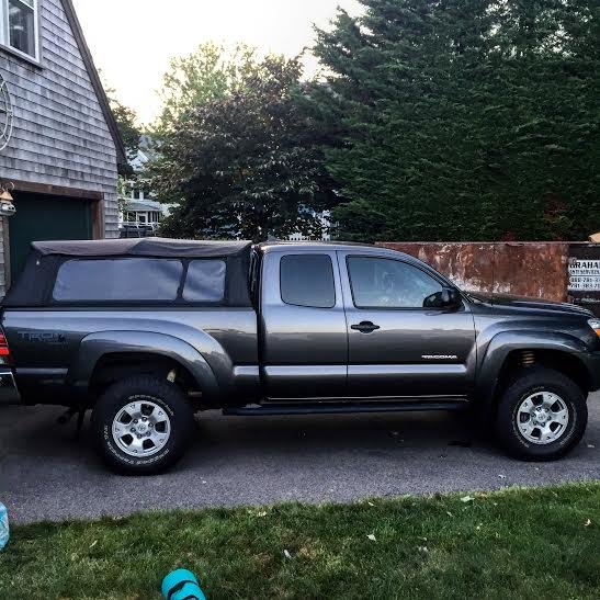

    Confession to make, looks like the rugged terrains I have already are 265/75/16's - after looking a bit closer they look pretty decent as is, replacing the ironman leaf pack with OME Dakar's will most likely give me .75" of lift over what i currently have which is exactly what i was looking for. In an effort not to go over board i may simply run a more aggressive looking all terrain and keep the 265/75/16's - I've seen some great set ups on here. Not having met the previous owner of the truck, from what i can tell with the insight of my local off road shop (SoCal Suspension) i look to be running a 2-3" ironman kit. I don't want to overwhelm the front end so i feel a 265/75/16 will be the perfect option with a 1.25" spacer for a more filled our stance.
    Thoughts -Suggestions?
    Below is a picture of my set up just before I drove across the country back in September 2015 form Boston to San Diego.
