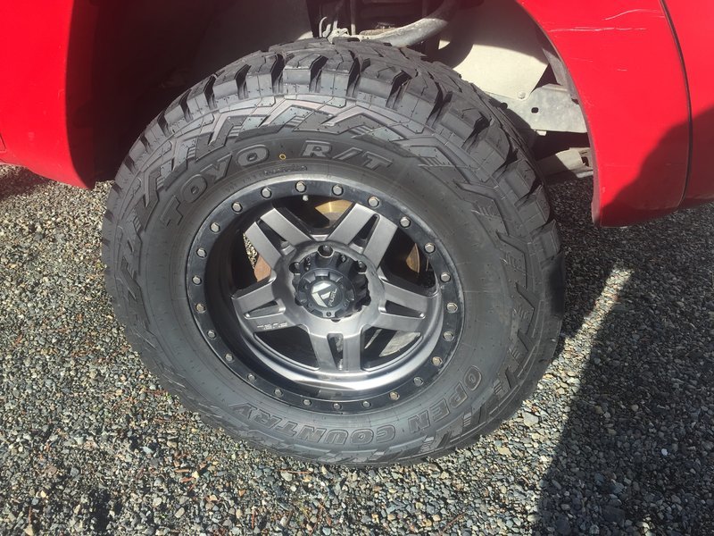

    3"lift 33x12.5x18 size TOYO R/T fit great

    I know tell me about it! I put these on about two weeks ago they have been great so far. I got 70,000 miles out of my last TOYO M/T tires in the same size and still could have pushed them to 80k. I live in Western Washington so I didn't want to end up hitting standing water on the freeway and end up rolled over in a ditch. So I upgraded early haha. Hoping to get 70-80k out of these.
