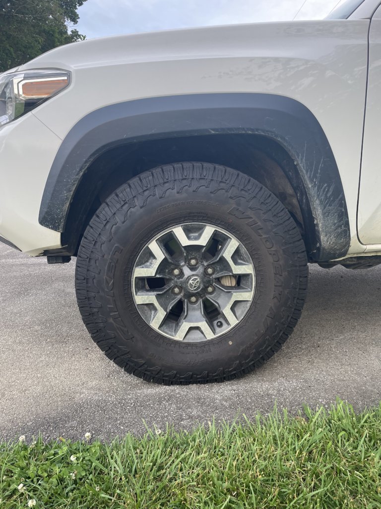

    I have a stock 2022 TRD Off-road that I I’ll be needing new tires on soon. I want to go bigger than stock size but without any rub. Also will be getting a 2inch lift after winter and don’t want the tires to look small once the lift is installed. Any suggestions?

    Do lift first ..then tires . Not all tires are the same and if u have the lift done already u can fit the tires easily that way instead of finding out later that tires are to small or rubbing .

    Second this, or just go 255/85 and save the lift money.

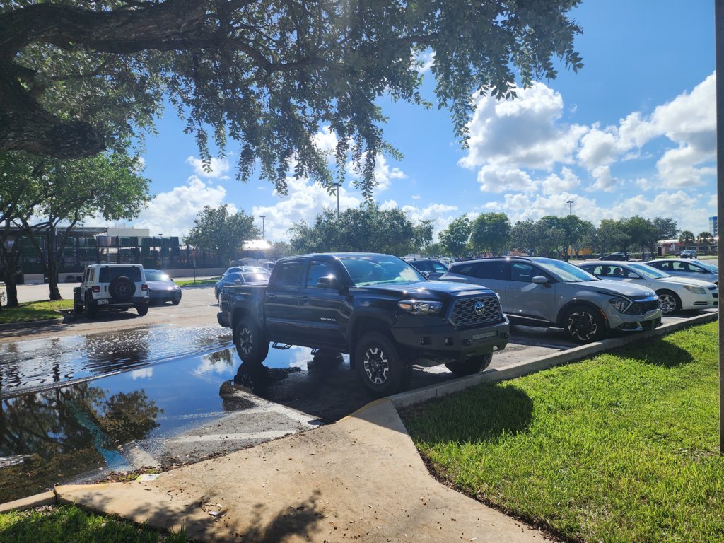

    Steelcraft Fortis front bumper, BodyArmor 4x4 rear bumper, LIft: Bilstein 5100+2885 OME coils, Icon RXT 3 stage. 255/85/16 wildpeak at4w
    Pizza cutters. 255/85/16 no need to change rims. with 2 inch lift you will have plenty of space around.
