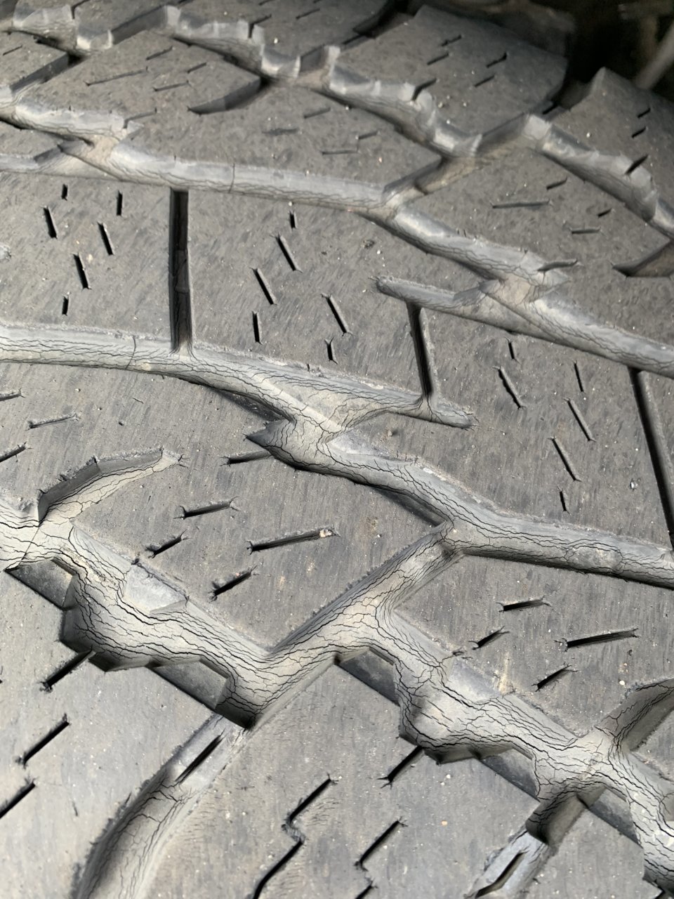

    I’m no tire expert and trying to do some research on how soon my tires need replaced. I’ve been to several shops and they all give me different answers. One said they need to be replaced like a year ago and another said I have probably another year left. They are Toyo Open Country AT2. Mamufactired and put on in 2013. Fast forward to current date they have 41k miles on them and there are cracks in between the treads. The pass the Lincoln penny test for now. Thoughts? F8CD585B-437A-48EF-95FA-8577E5C52BDF.jpg

    You want to cheap out on safety?

    I’m most definitely not trying to cheap out on safety. But when I’m getting multiple responses from shops I thought I’d turn to the knowledge on the TW forums. The shop responses were: that’s typical tire wear but plenty of tread life left run it, or those are defected tires you need new ones, or yeah those are cheap tired that’s what happens should have bought such n such brand, or those are going to disentigrate any second.

    Replace tires every 5 years regardless of wear.
    The rubber degrades and dehydrates over time

    And you still have to buy another set of tires.

    Sunlight breaks down the rubber. A tire in Michigan will last a lot longer than one in Florida. A vehicle stored in a garage will keep the tires safe longer than one left outside all the time. The 5-8 year recommendation is just a SWAG. The tires could be bad after 3 years or still good after 10 depending on where they are.
    I wouldn't trust those tires. It's not one thing, but a combination of factors. At 63,000 miles you got your money's worth. I might not run to the tire store tomorrow, but would buy new tires soon.

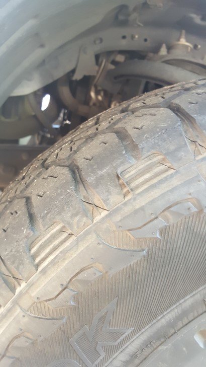

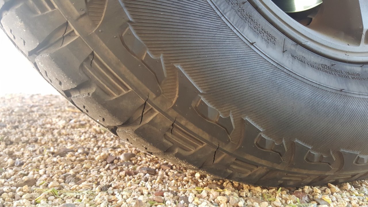

    Came across this thread when researching the cracks on my own Dynapro ATMs. Thought I would share my experience to anyone else who is looking into this. As you can see, the cracks in mine appear severe, Discount Tire wouldn't even rotate em, just told me I need new ones. However, I got 75,000 miles on these (in 4.5 years after manufacture date). My brother had the same tires on his Tacoma and got 70k miles out of them. For tires rated for 50k miles, I'm happy with how they performed, especially in the Arizona sun and heat. Trying the Nitto Ridge Grapplers next.

    As the saying goes. "Tires are the only contact that you have with the road".
    How important are those contact points to you?
    They could mean your life
