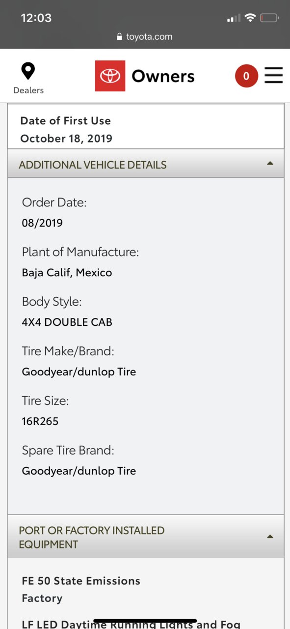

  19. Jul 14, 2020 at 9:05 PM
    #59
    tarafromflorida
    tarafromflorida [OP] Active Member
    Jul 14, 2020
    #334493
    40
    Tara
    2020 Tacoma Trd Off Road
    None! I bought the “upgraded” package. Moonroof etc
    From Toyota website. Tire type.
    RobP62 likes this.
