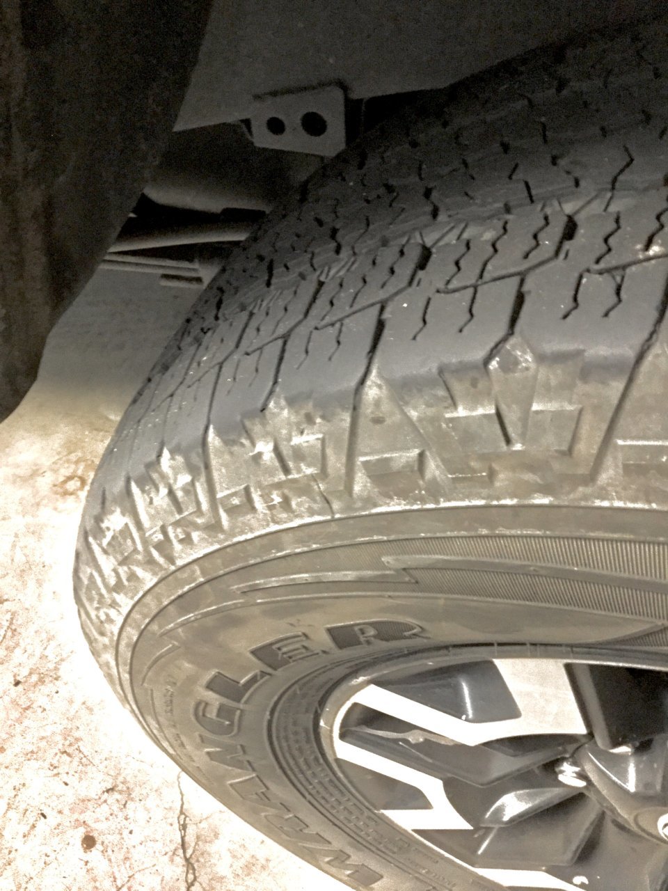

    So you think this is normal? For 14,000 miles. I’m totally cool w that. I just don’t know what’s normal and if it’s not, I want to fix it sooner than later

    That looks like positive toe(toe-in) wear since it usually affects just the edge.
    Camber wear usually affects the whole tread; turns the tire into a cone.

    30psi is way to low for that tire (on the Tacoma) on blacktop imo. I’d be running that at 33-34psi on pavement.

    You would think that they would be in better shape at 25,000 miles seeing how they get rotated every 5,000 and I check the pressure regularly. I’m going to run them out and decide what to replace them with.

    Ya. I’m surprised because they aren’t an aggressive tire to begin, thought they’d be in better shape at that mileage

    I've had 3 free oil changes and they told me I needed an alignment at each one. The just spit out the "we recommend it once a year anyway". Nobody should have to or does this. I'm getting bigger tires soon anyway so I got 21k and they look half worn. Same wear as yours.

    So......... I went back in today. they asked “what can we do” and I told them I wanted the problem fixed and new tires. (I had a nail in one, it needed replacement) So we could go half each. They agreed. They tried to offer the buy three get one free that anyone can get any day.
    I maybe should have persisted w replacing the three for free (I have no prob paying for the one that needs to be replaced with the nail) I think this is more than fair on my part

    If you put new tires on, you definitely need to have the alignment checked. And probably checked by someone other than the dealer. Once you get it aligned, make sure to get a print out and post it up here to be analyzed by the TW arm-chair mechanics.
