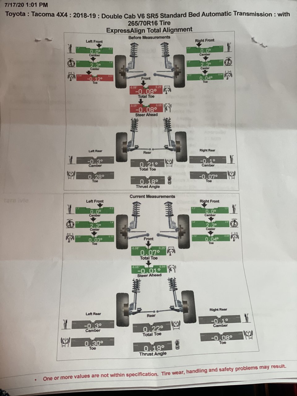

    The top is before. Bottom is after an alignment. if anyone had any input, great!! I’m wondering if this is way off or “just a little”
    I got all new tires. I paid for two (one had a nail in it had to be replaced, def my fault) they paid for the alignment and two tires.
    Overall I’m happy with the outcome. I wish I hadn’t spent the last few months worrying about a brand new truck’s tires and didn’t have to spend so much time at the dealership. I’m running 36psi as suggested here. If I pull something, I’ll bump it up to 40. thank you all for your help!!

    Idk if it matters that they have the wrong truck type and year wrong

    Shouldn't matter...
    It's not what I was expecting to see; just the opposite.

    Your alignment was perfect. I’ll say it ONE more time, you need to be running 35 PSI or more. They are cupping because your pressure is too low.

    Yeah, totally agree. Negative toe means they were pointed outward i.e. duck footed. They should have been showing wear on the inside.
    The adjustment was pretty minimal. A slight toe set. Camber and caster looked good and were unchanged.
    I hate to say someone is wrong, but Sharpish is not correct in their theory that low air pressure causes cupping. It does not. There is nothing wrong with running 35. More air is usually better. Your tires run cooler and if they run cooler, they last longer.
