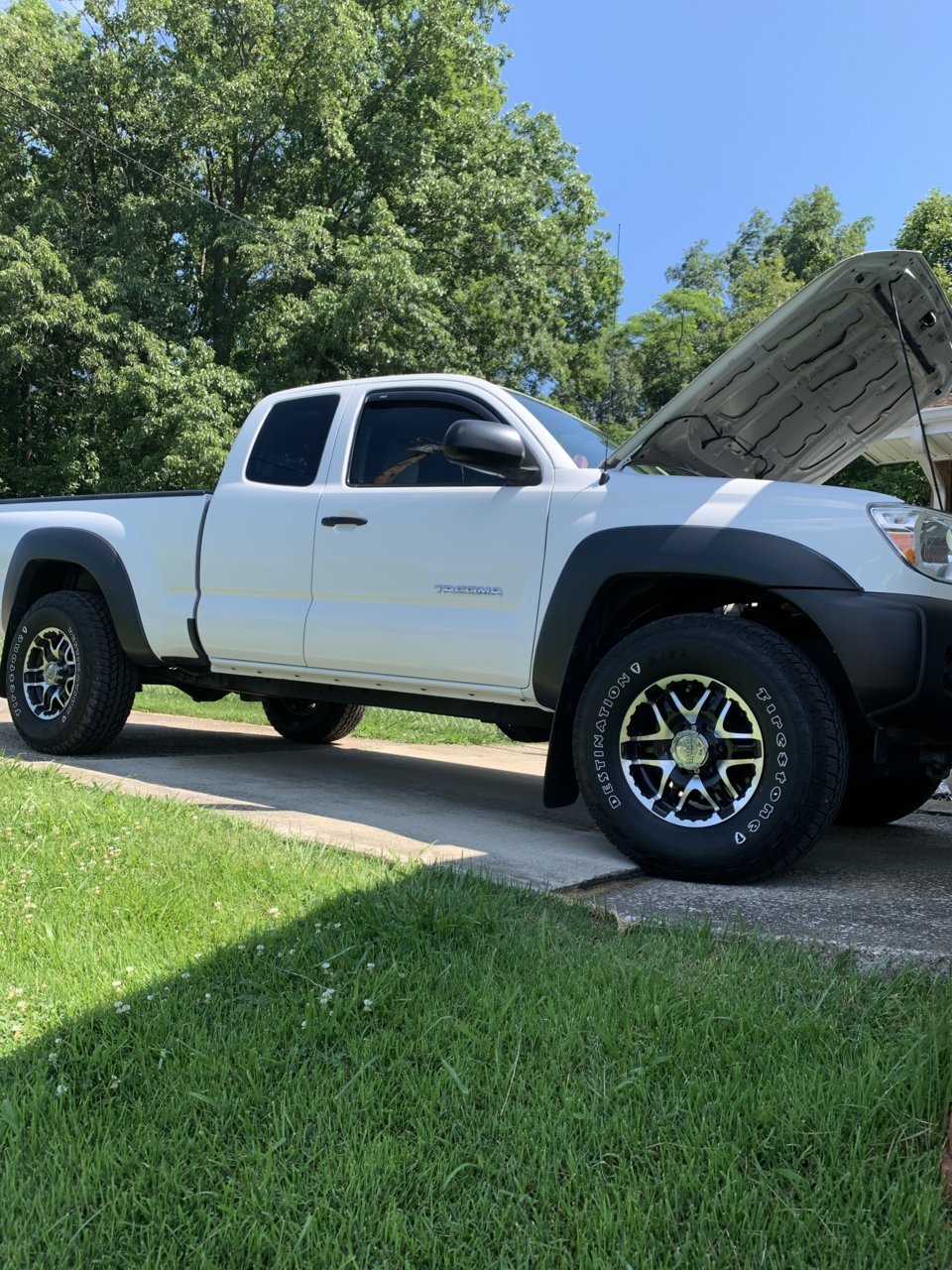

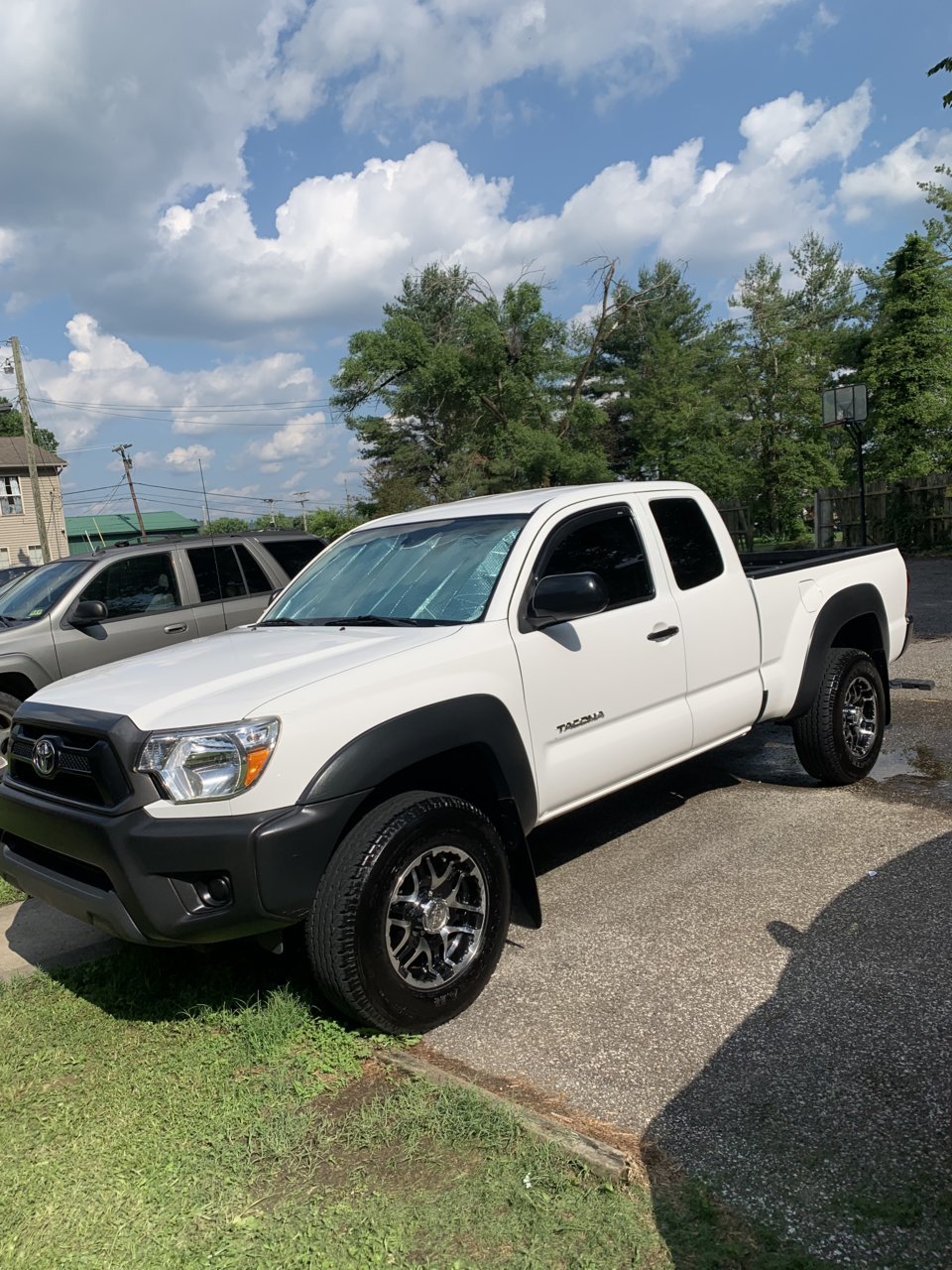

    I was able to fit firestone destination a/t2 265/75/16 on my stock 15 4x4. They have only been on about a week but I haven’t experienced any rubbing. I can even post before and after pics in the morning if you would like to help you decide.

    With 245/75/16
    With 265/75/16
    Hope this helps, the difference is only about an inch
